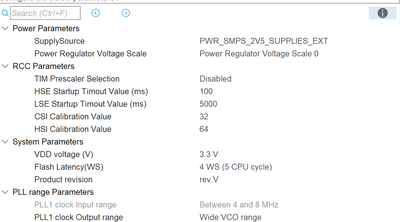

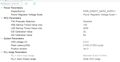

2024-12-15 9:44 AM
i got same issue on NUCLEO-H755ZI board.
code is stuck because VOSRDY=0 always.
The power configuration is matching with this board.
I saw a example can be running, but the power configuration is totally not matching the board, WHY!!!!
The 2.5V may damage the VCAP!!! but this configuration is working.
