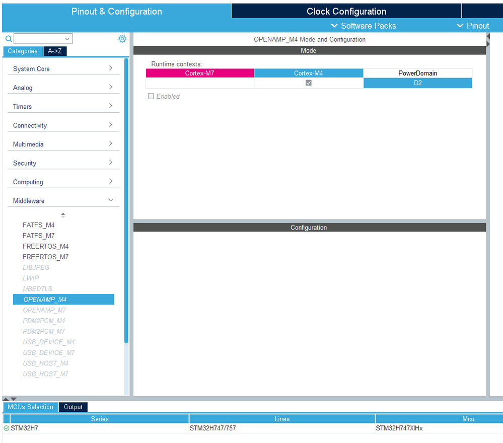

I'm using STM32H747 disco with Cube MX and Keil. I have don't enable "openamp" in Cube MX. I have downloaded and added STM32MP1 packages but it didi't change. Anyone know that how to solve this problem? Thanks.

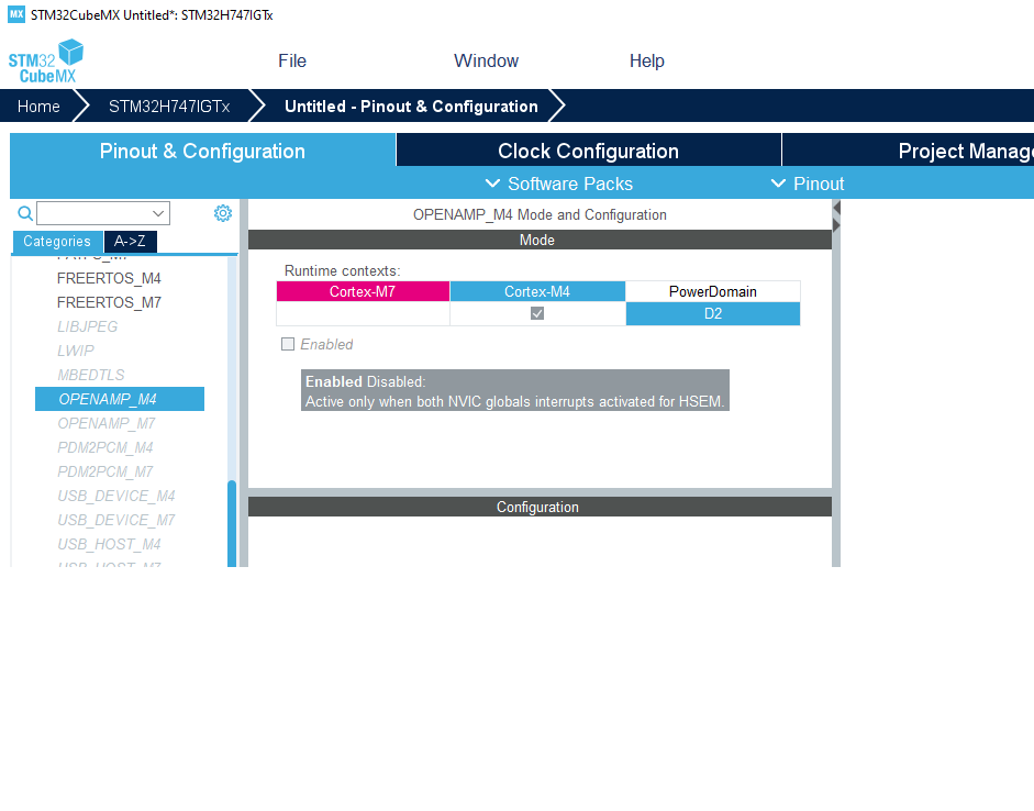

You should activate NVIC interrupts for HSEM.

Hello @Cenk KILIÇ and welcome to the Community :)
Which CubeMx version are you using ?
Can you please clarify more your issue ? (share screenshot)
Do you get an error message ? Maybe you have the OpenAMP issue (described in the RN CubeMx v6.3.0) when compiling under MDK-ARM.

Cube MX version is 6.3.0. I can't enable openamp both of CM4 and CM7.

If you hover over the grayed out "OPENAMP_M4" text, it will tell you the reason it's disabled.
In this case, you likely need to enable the HSEM interrupts in HSEM1/HSEM2 interrupts in NVIC1 and NVIC2 in the "System Core" section.
