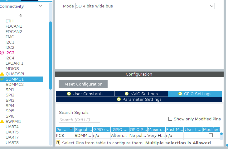

Here's the configuration for SDMMC1 on the STM32H743

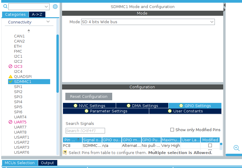

And here it is for SDMMC1on the STM32F7
Notice that there is no DMA configuration option for the H7, but there is for the F7.
Does this mean that ST doesn't have DMA based drivers on the H7? With the polling drivers, my performance is extremely slow -- something like 0.2MB/sec.

My reading of the stm32h7 reference manual suggests that the SDMMC module has its own built-in DMA controller IDMA.
You can't use DMA1 or DMA2 so there's a lot less to configure.
(I think you can use the MDMA for SDMMC DMA).
Now how much of this is brought out to stm32Cube is down to ST. You might have to write your own code to use the SDMMC IDMA.
(My main use of STM32Cube is to explore how I might distribute my required peripherals amongst the ones present on a microcontroller, as there are a lot of shared pins and DMA channels/streams. I tend not to use its code-generation ability.)

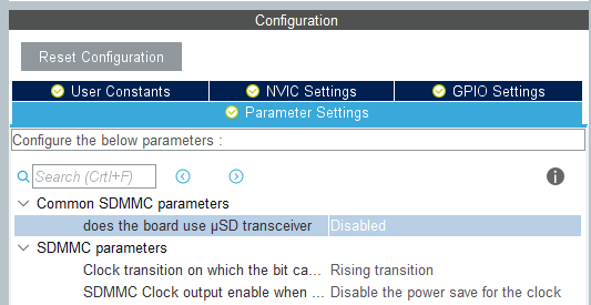

STM32CubeMX 5.3.0 has the option under SDMMC "Parameter Settings"
