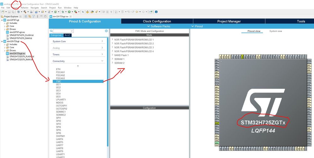

Hello. I cerate new project for stm32h725zgt chip and can't activate any of FMC interfaces. It's not active. On stm32f767vgt in past all was ok. What I now do incorrect?
How I can to fix this problem?

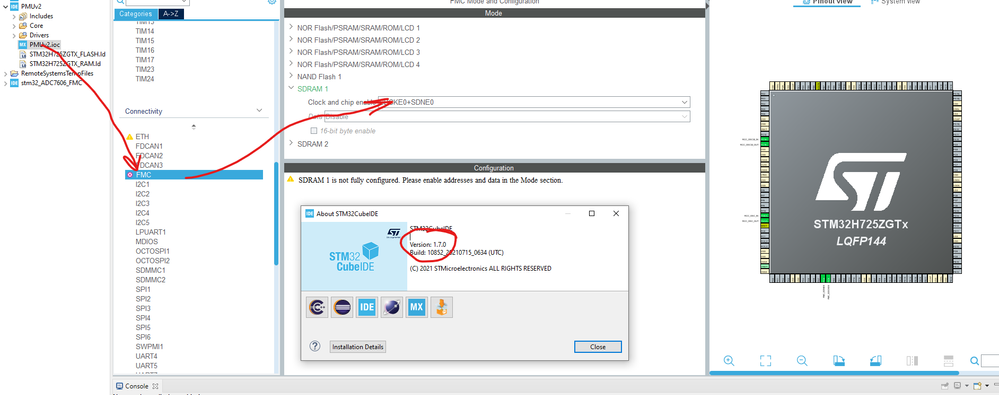

I Just create a project and activate "clock and chip enable" in SDRAM1 section of FMC. Any other field is stay inactive after activatation. On popup window written "Data disabled: Internal bank number disabled". In other section ("NOR Flash/PSRAM....") same situation in any configuration
2021-09-10 5:09 AM
Problem, that its not activated after "clock and chip enable" enabling

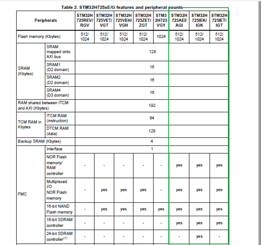

Actually, as already stated by @TDK , STM32H725ZGTx does not support the SDRAMs. Referring to STM32H725xE/G datasheet , the SDRAM1 is only available for H725Axx and H725Ixx:
With this being said, the the current implementation of the FMC for H725 devices in STM32CubeMX will be reviewed and updated in a near future release.
