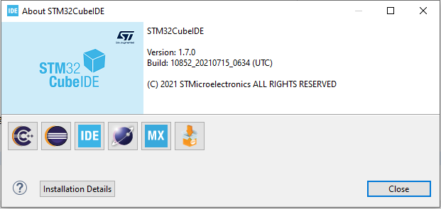

I use STM32CubeIDE:
CubeMX version:
Firmware Package Name and Version : STM32Cube FW_H7 V1.9.0
