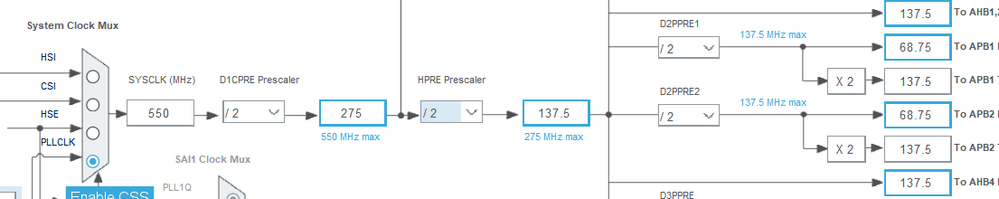

In my opinion the CubeMX generated clock initialization is in the wrong order and this seems to potentially cause hardfaults.
Consider following example configuration:
This should be valid according to CubeMX and my understanding. BUT:
In the initilaization code, CubeMX *first* picks the PLL as system clock and only afterwards sets the prescalers.
Generated code (SystemClock_Config):

[...]IF I change the order and only call LL_RCC_SetSysClkSource AFTER all the APB prescalers are set, then everything works (=> no more hardfault).
I'm not sure that my understanding is correct.
Could someone more knowledgeable please confirm that this ordering-issue is indeed causing the hardfaults?
µC: STM32H730VBH
CUBEMX: v6.3.0
Edit:
I'm pretty sure this is a problem exactly as described. AFAICT the problem can be hidden by instruction prefetching, but when single stepping (on instruction level), this hardfaults directly after SetSysClkSource (presumably because the default prescaler values are too low at that point).
