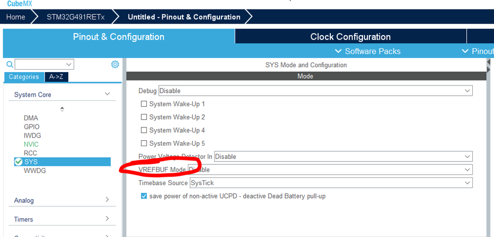

In ST Cube IDE 1.6.0 project, Cube MX view - > vrefbuf is missing from syscfg page

The STM32G491KE doesn't have a VREF+ pin. It's bonded internally to VDDA. Enabling the voltage buffer would mean it would need to fight with VDDA, clearly not a workable scenario.
From the datasheet:
The VREF+ pin is double-bonded with VDDA on some packages. In these packages the internal voltage reference buffer is not available.

It's there for me. Share your IOC file if able and/or screenshot. CubeIDE v1.7.0 is latest.
From the datasheet:
