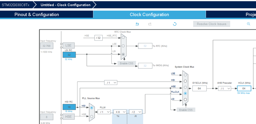

> 2: Cube MX cant enable 64Mhz on the clock config (max 48Mhz) a bug?
Works fine for me.

Have the latest Cube MX 5.6.1 , it shows TIM15 but PLL have only div/mul stage
and 3 way mux and not as in your picture. However if i switch over to a G030K/071C
then i can set 64Mhz core clock and TIM15 vanish and can set the DMAMUX .
So something is weird with Cube MX and as usually with ST data sheets needs revisions, e.g picture on cpu says 56Mhz!

Hi @GBral.1 ,
I selected STM32G030C8Tx on STM32CubeMX and try to check what is the issue, but didn't catch it, sorry.
Could you please explain more what is wrong from your point of view on documentation and STM32CubeMX?
Thanks.
-Amel

Hi
CubeMX 5.6.1
STMCudeIDE 1.3.1 (CubeIDE 1.3.0 was not working properly.)
None of issue mentioned, work fine no trouble on DMAMux, PLL too.
