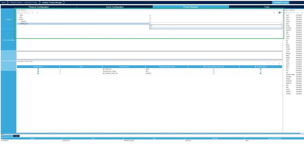

In fact STM32CubeMX allow you to choose between HAL and LL based code generation for a given peripheral instance: it offers the possibility for some peripherals to generate initialization code based on Low Layer (LL) drivers instead of HAL drivers.
You can choose between LL and HAL driver in the Driver Selector section and the code will be generated accordingly:
I hope that this answers your question. If not, could you please clarify more your request.
