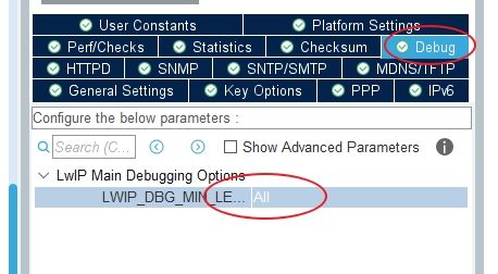

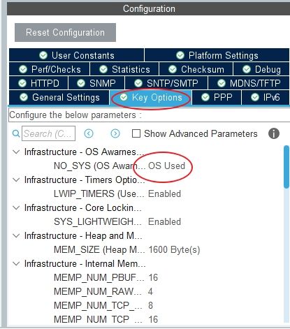

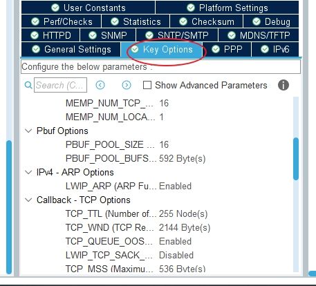

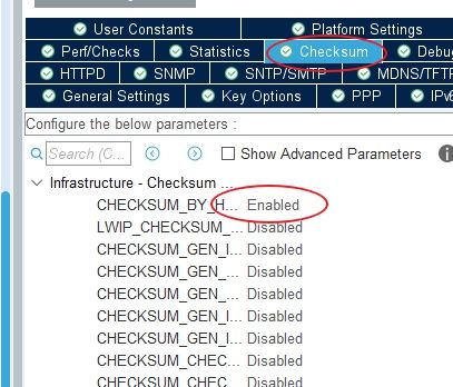

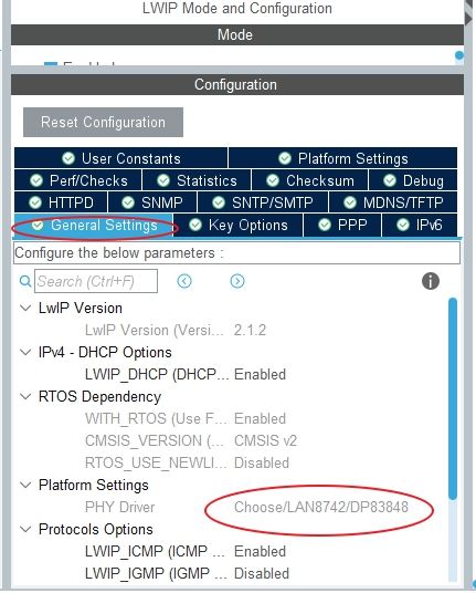

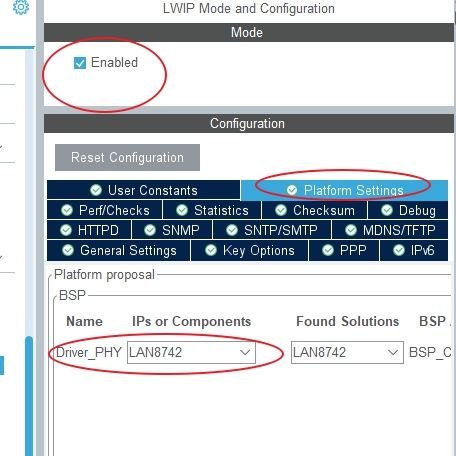

2023-02-28 5:05 AM
my STM32CubeMX version is 6.7.0
