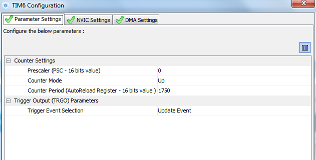

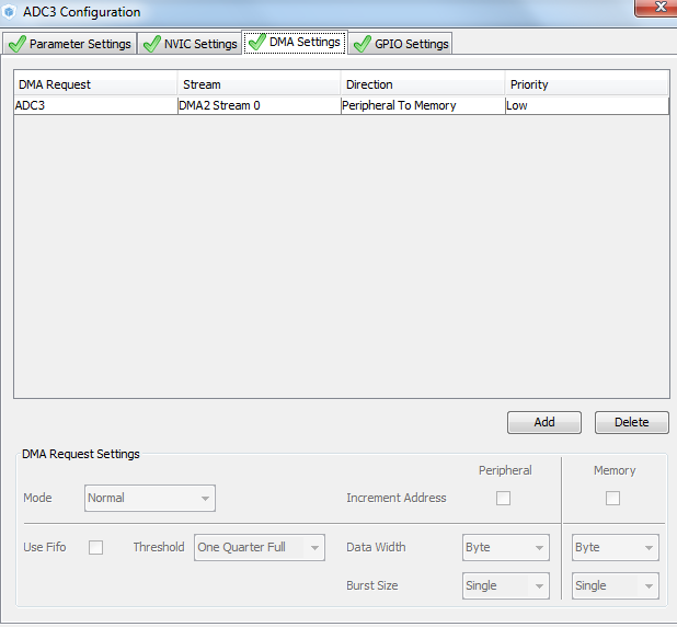

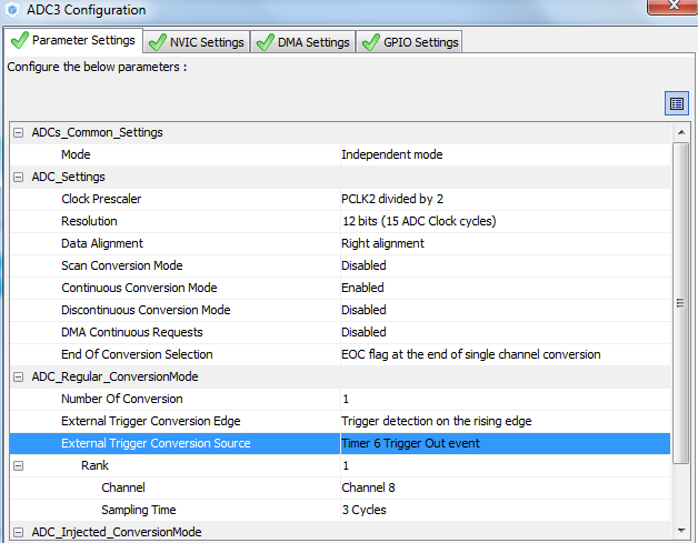

I have configured the ADC to trigger based on Timer 6 update event every (1/48000) seconds. DMA is used to transfer the ADC conversion to memory. However, when I debug, I see the timer count being incremented, but I don't see any ADC conversion being made or anything in the memory location where it saves the ADC values through DMA. I have used ST's CubeMX to generate the initialization code.#include ''stm32f7xx_hal.h''

ok, I have narrowed down the problem a bit. The issue lies with the Timer 6 not triggering the ADC.
I guess I could use the timer interrupt to manually trigger the ADC conversion on overflow (1/48000s), but I would rather like to have it trigger automatically. Any suggestions?2015-08-05 7:00 AM
There is probably salient code missing for timer configuration. See the ADC Trigger Mode example that comes with the HAL library.
Cheers, Hal2015-08-05 8:58 AM
I had no idea there were more examples in the STM32756G_EVAL folder. I was previously only looking under the STM32746G-Discovery folder, and there is only one ADC_regular_conversion_DMA example. T
Anyways, I looked at the main.c file of the ADC_TriggerMode example and found the following differences: 1. Before starting the timer using the HAL_TIM_Base_Start(&htim) function, they have enabled the DAC clock using __HAL_RCC_DAC_CLK_ENABLE(); 2. Under the timer configuration, they had MasterConfig.MasterSlaveMode = TIM_MASTERSLAVEMODE_ENABLE, whereas the initialization code that was generated by CUBEMX has MasterConfig.MasterSlaveMode = TIM_MASTERSLAVEMODE_DISABLE
3. in addition, they have used Timer 2 instead of Timer 6, but that shouldn't really make a difference. I currently don't have access to the discovery board, but do you think these differences are what's causing timer 6 to not trigger? Thanks for the help.
