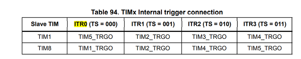

I know TIM2_TRGO should get in ITR1 of TIM1 according to this chart.

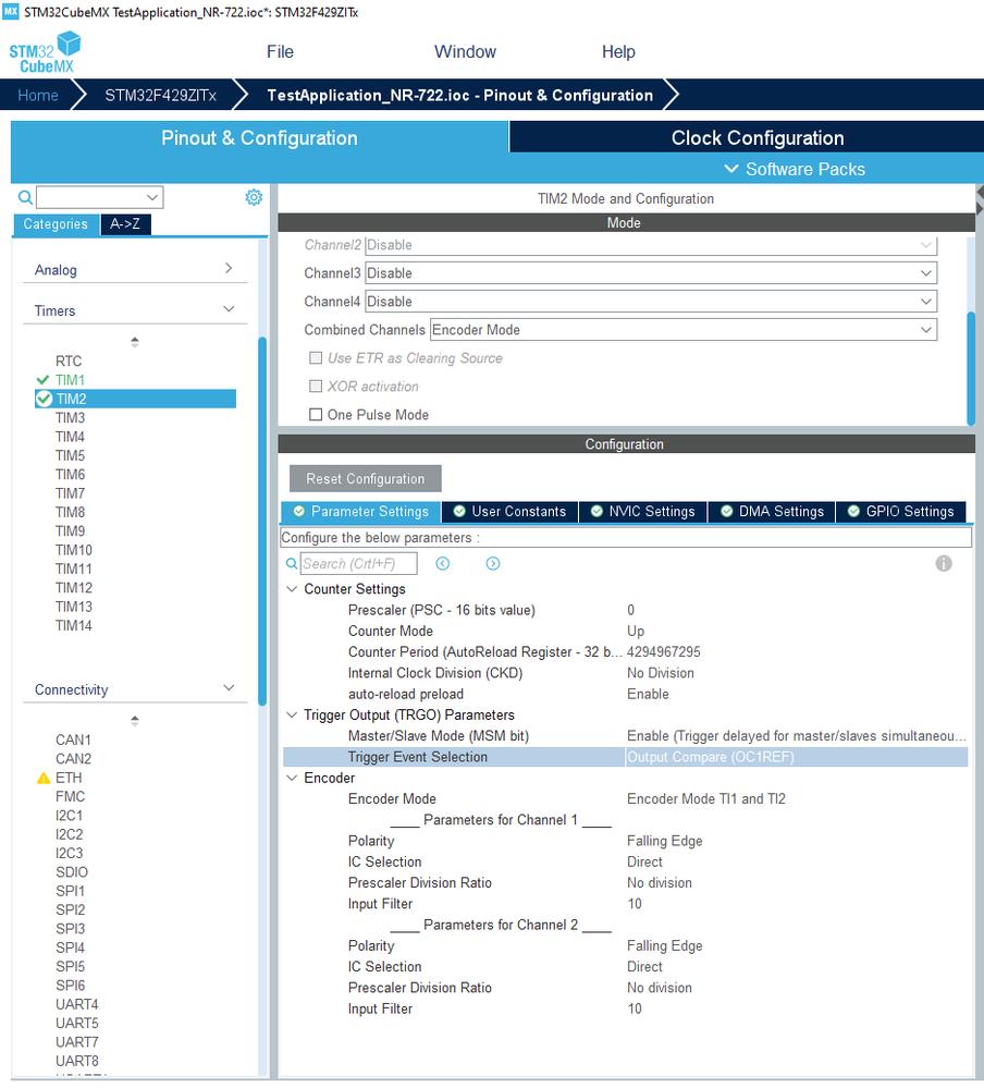

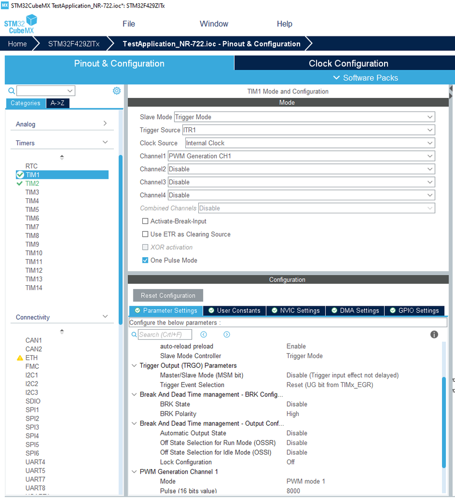

here is my setup on CubeMX;
