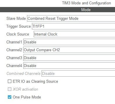

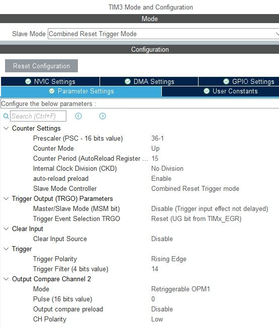

I am using a TIM3 configured in OPM mode, trigger source set to TI1FP1.

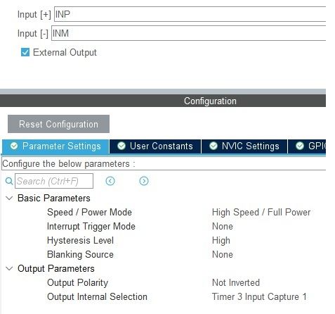

The COMP1 and COMP2 outputs are configured as internal connection to TIM3IC1. If I turn on only one comparator everything works, if both are on, it doesn't work. Configuration is done via CubeIDE. Maybe CubeIDE is setting something wrong. Is the simultaneous operation of the comparators possible? Do I need to find another solution?

What is "doesn't work"?
That's irrelevant. The mcu works out of content of the registers. Read them out and check them.

How did you verify that output of the comparators reacts to your input signals?
Note that output of the two comparators is ORed together, i.e. if one's output is one, output of the other is ignored.
