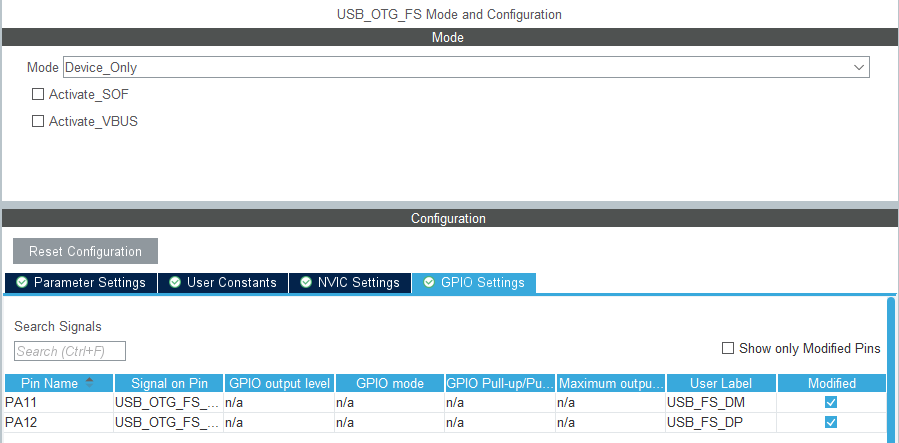

I found the function responsible for USB initialization: HAL_PCD_MspInit
But there were no pin initialization for DP or DM pins.
Throughout the whole project I could'tn find any initialization on DP or DM pins.

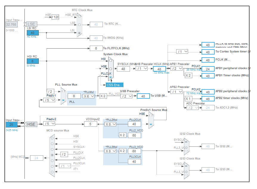

MCU is driven 25MHz

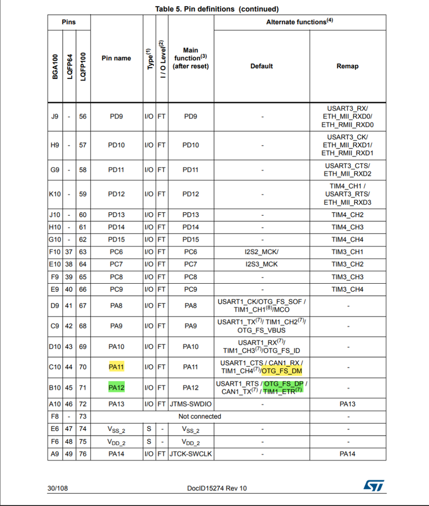

I figured out by chance that without even assigning USB to these pins, USB is assigned.
I think the default assignment of these pins is USB. But I'm not sure.
But it would be better to see this assignment somewhere in the code. Because it becomes confusing this way.

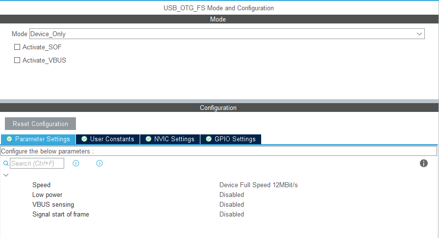

I figured that the VBUS needs to be detected by the microcontroller to to be detected by the PC.
This is stated in the USB FS specification. And in STs AN4879, USB hardware and PCB guidelines using STM32 MCUs.
Also in a forum, I read something like this.
disable VBUS activation, set PA9 output and set it to default High.
https://electronics.stackexchange.com/questions/251856/usb-on-stm32f107rct-and-stm32cubemx
When I did these steps the microcontroller is detected as a USB device by the PC.
But I think the safest option is to sense the VBUS.
