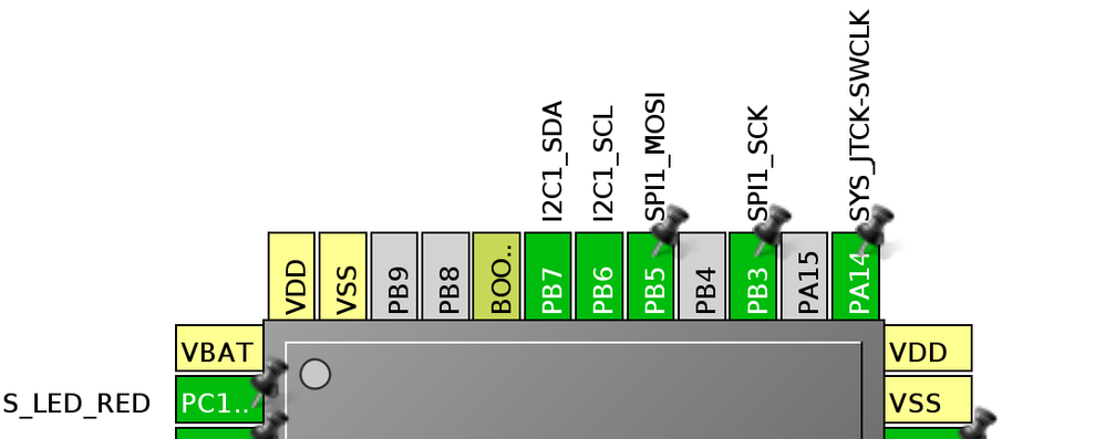

The CubeMX configuration is the following for the pins:
I2C on PB-7 SPI on the PB3-5 (MISO is unused). The generated GPIO initialization code looks ok for me.

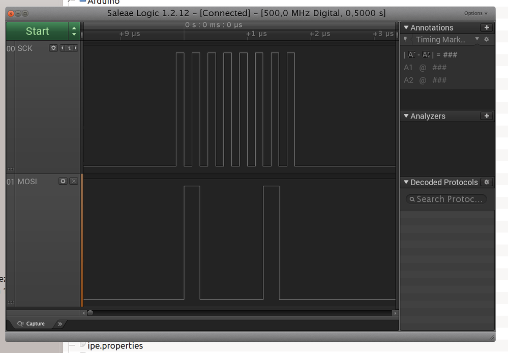

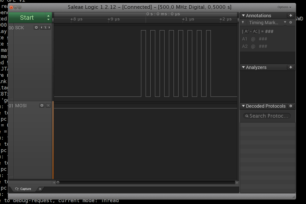

If the I2C1 module is enabled there is not any output on the MOSI line even if sending non 0xFF data:
I have narrowed down the source problem to the __HAL_RCC_I2C1_CLK_ENABLE in the HAL_I2C_MspInit.
If I remove that the MOSI output will work as expected. (Of course in this way the I2C peripherial will not work):

I think you have run into the issue 2.8.7 of the errata
.PB5 cannot be used as MOSI signal when the I2C1 is enabled.
Use PA5-6-7 for the SPI instead.

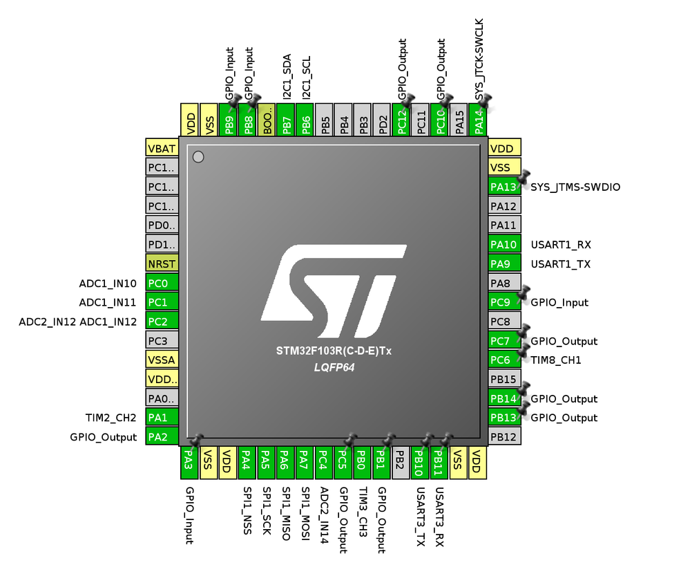

Thanks to @waclawek.jan I discovered a similar issue also on a STM32F103RET7 mcu, with the main difference that I DID NOT CONFIGURE I2C1 (even if I designed a I2C bus on PB.06/PB.07). My configuration is as follows:
And I had to disable AIN+DMA, USART1, USART3 and all the timers to have MOSI properly moving (well, the M95128 eeprom is still not answering to the Read Status Register request, but this is another issue i have to work on). I'm now in the process of selectively enable the other functions in order to discover the interference with SPI1.
