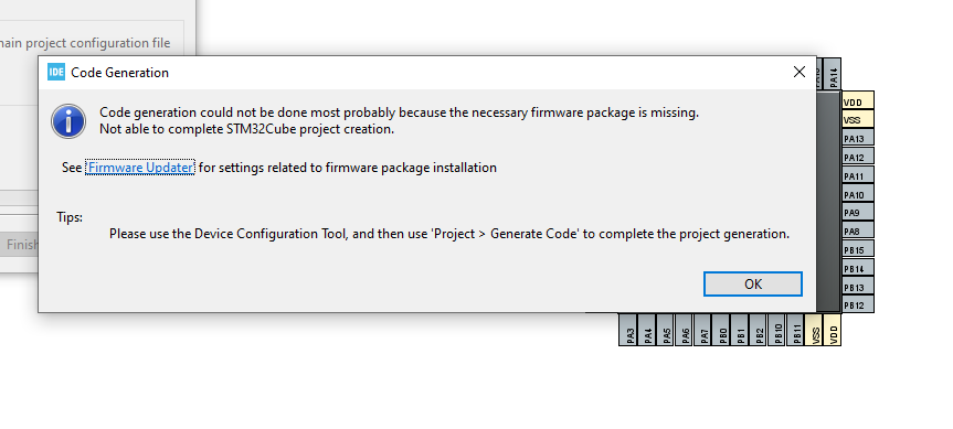

I forget to tell this thin it says that something is missing for code generator. I am not sure if i have to do update something manually?

Hello @tensaisakuragi06
You are using the latest version of STM32CubeIDE but you are missing the firmware package.
In fact to download firmware packages to create projects, you need to connect to your st account in STM32CubeIDE.
Check the STM32CubeIDE user manual UM2609 section 1.2.3 STM32CubeIDE user authentication for more details.
