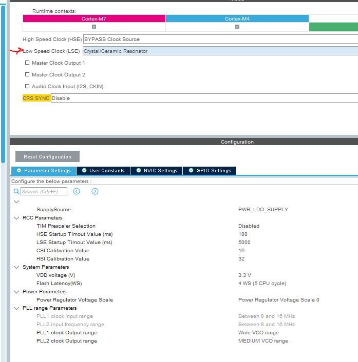

Hello, i have found some bugs

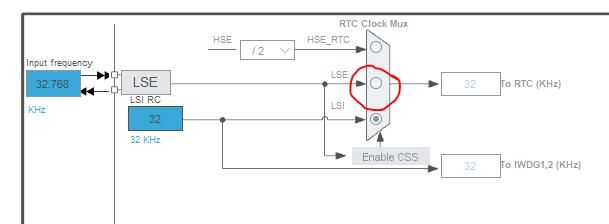

I can't select the external 32 khz osc .

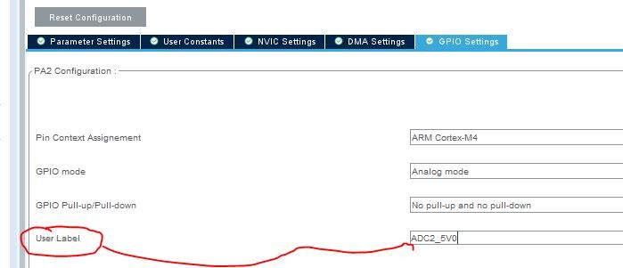

the input field of the User Label have some problems
edit this fields don't work properly

Hi @Hans T
So to conclude, for the first problem related to LSE activation : you need to Enable RTC if you want to change RTC Clock Mux.

2020-12-04 6:10 AM
Hi @Hans T
For the LSE Problem : you need to Enable RTC in you want to change RTC Clock Mux.

2020-12-04 7:26 AM
->For the LSE Problem : you need to Enable RTC
yes, it works thanks

2020-12-04 9:18 AM
Enter User label in the Pinout view works good
only the UserLabel in the Configuration field is an problem
2020-12-07 12:14 AM
@Hans T ,
Please share your ioc file to check the problem, and can you specify where exactly the Problem ? ( Under which IP ? Pin name ? )

2020-12-13 1:40 AM
I send you the IOC PM
2020-12-14 2:29 AM
Hi @Hans T
For the seconde one which is a problem with User Label, thanks for sharing your ioc file to reproduce the issue, you're right and it will be fixed.
