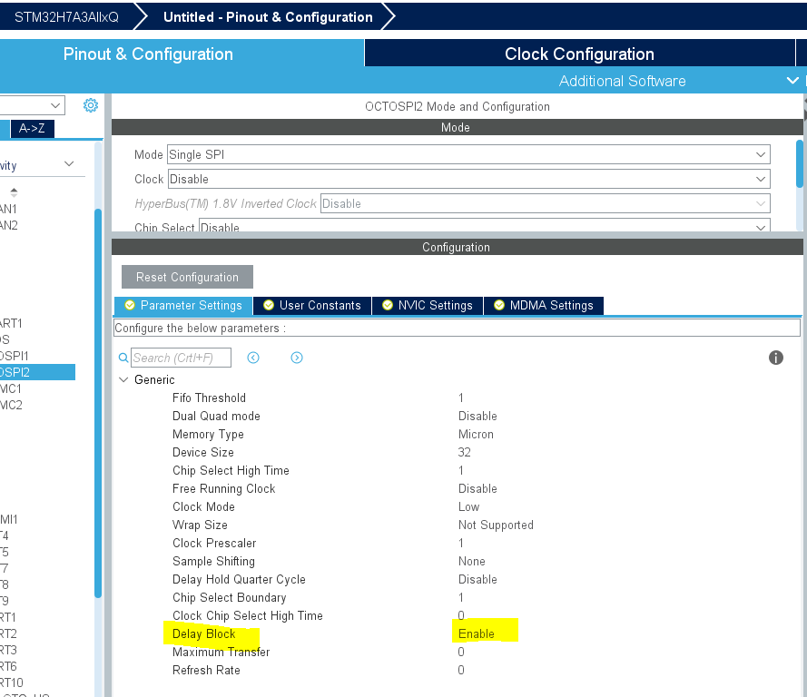

Using STM32CubeMX/STM32CubeIDE - when enabling and configuring the OctoSPI peripheral (Hyperbus mode) on STM32H7A and enabling the Delay Block feature, the LL driver for DelayBlock does not get included in generated projects.
I had to enable SDMMC1 to force inclusion of this driver, and even then it needs modification because it assumes that the MCU has a QuadSPI peripheral (not correct for STM32H7A).
Am I doing something wrong, or is this an issue in STM32CubeMX/STM32CubeIDE?
Thanks

HI,
I was using CubeMX 5.6.1 (latest availabile until recently) - in this version the H7 has an option for "Delay Block" in the interface, but when generating code, there was no code generated which actually used or configured the H7 Delay Block peripheral. So the "Delay Block" option in CubeMX 5.6.1 for H7 OctoSPI was useless and produced nothing.
I will check again with CubeMX 6.0.0.

i'm working with CubeMX 6.7.0 and the option Delay block enable i the octospi peripheral in CubeMX just affects this line:
hospi2.Init.DelayBlockBypass = HAL_OSPI_DELAY_BLOCK_BYPASSED;
hospi2.Init.DelayBlockBypass = HAL_OSPI_DELAY_BLOCK_USED;
it doesn't configure/enable the delay block peripheral!
