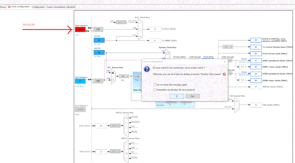

I've the same problem using the plugin STM32CubeMX 4.0 and Atollic TrueStudio STM32 9.0.1.
I have two PC with Windows 10 installed. The one with italian language has the problem but the one with english has not. Another PC with Windows 8.1 ( italian language ) shows exactly the same issue.
Very strange.
NewProject-><Board selector>->NUCLEO-F401RE->Clock Configuration
Result :
The automatic issues solver doesn't fix the problem.
Best regards.
