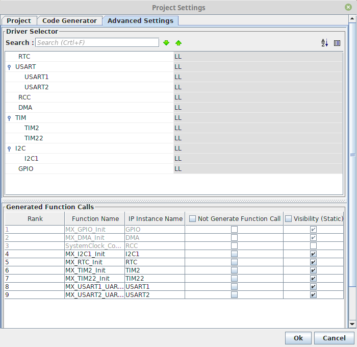

I use STM32L0 series microcontroller with LL and CMSIS libraries, no HAL is selected in the advanced settings tab, only LL.
And still, when I enable the "Flash and EEPROM global interrupt" in the Configuration -> NVIC, STM32CubeMX starts using the HAL library and generating code for it. As I understand, LL (at least for STM32L0) misses a module for working with Flash, but still, I think this is a bug.

More information: I have checked "Copy only the necessary library files" radio-button and "Generate peripheral initialization as a pair of '*c/*.h' files" checkbox.
