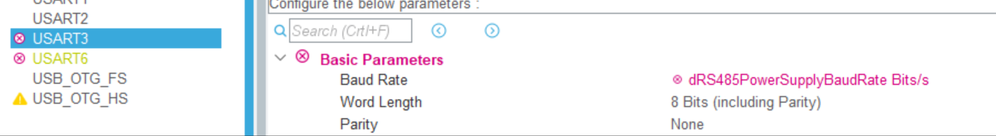

Whenever the IOC file is opened again and I try to regenerate the code, the STM32CubeMX 6.0.0 for no reason start THROWING WARNING about the Drivers which use the macros similar to the ones shared above. Please refer to snippet STM32CubeMX-6.0.0-Code-generation-concern.png for details.
Also refer to STM32CubeMX-6.0.0-macro-declaration.png to refer to some macros that have been declared. Please check the items encircled with red line.
Also please refer to Initially-allowed-using-macro-but-on-repoening-IOC-shows-a-red-cross.png file. Please observe the red cross marks.

Not sure there's a bug here. CubeMX is set up to take a numeric value for the baud rate. You're feeding it a user defined macro. It happens to expand to an integer, but CubeMX doesn't know that. Sounds like a feature request more than a bug report.
2020-10-02 1:32 AM
Hello @TDK
The reason I reported this as an issue is because there are two different behaviors shown by STM32CubeMX.
The correct behavior is shown by STM32CubeMX shows when the IOC file is open and user first adds the macro (like dRS485PowerSupplyBaudRate) and then assigns the macro to one of the property (i.e. to Baud Rate). If the IOC file is saved and code is generated without closing the project, then STM32CubeMX does not throw any error.
