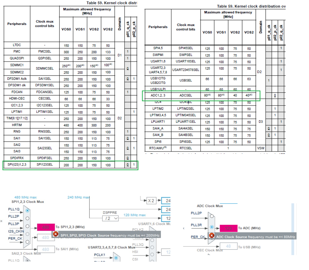

Actually you're right, I was able to reproduce the same issue when trying to load your attached projects. The problem is mainly due to the Continue option.
In fact, with previous versions of CubeMX (6.1.0 / 5.6.1) there wasn't any clock constraint which wasn't correct. Backing to STM32H742, STM32H743/753 and STM32H750 Reference Manual > Table 59. Kernel clock distribution overview, each IP has its maximum allowed clock frequency depending on the Power Regulator Voltage scale value:
I assume that this misbehavior is due to the ADC clock frequency (120MHz) and SPI clock frequency (480 MHz) exceeding the maximum value stated in the Reference Manual. Thus, the implementation of the clock constraint in the latest CubeMX version may have impact on the loading of some IPs.
With this being said, this issue will be reported internally for review and fix. I'll keep you posted with the updates.
Sorry for any inconvenience that this may cause.
Meanwhile, I recommend you to use the Migrate option when opening your old projects.
