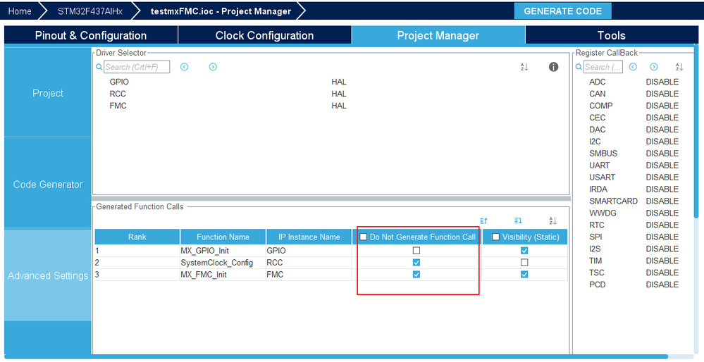

2020-09-30 7:31 AM
Just a workaround, but that could maybe help in your case. In STM32CubeMX, In Project Manager>Advanced Settings, you can disable the call to the init function.
In that case, the init function will still be generated and present in the main.c file, but without the call to them in the main().
And if not used at all, those functions will be removed during the build process and not present in the final binary.

Thank you for your reply. I think you might be on to something there. I had already disabled the FMC function call, but the problem was it still initialised the FMC clocks which crashed the app. Instead, what I could do is this:
