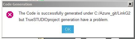

Trying to get to a version greater than 5.01 generates this popup (5.1, 5.2 or 5.6) :

2020-03-09 15:35:02,366 [ERROR] FreeRTOS:936 - Null or empty value: should not occur! (nothing added to the table)and later this :
2020-03-09 15:40:45,180 [INFO] ToolchainGenerator:445 - stack trace : java.lang.reflect.InvocationTargetException
at java.base/jdk.internal.reflect.NativeMethodAccessorImpl.invoke0(Native Method)
at java.base/jdk.internal.reflect.NativeMethodAccessorImpl.invoke(NativeMethodAccessorImpl.java:62)
at java.base/jdk.internal.reflect.DelegatingMethodAccessorImpl.invoke(DelegatingMethodAccessorImpl.java:43)
at java.base/java.lang.reflect.Method.invoke(Method.java:566)
at com.st.microxplorer.plugins.projectmanager.model.ToolchainGenerator.CallMethod(ToolchainGenerator.java:274)
at com.st.microxplorer.plugins.projectmanager.model.ToolchainGenerator.update(ToolchainGenerator.java:437)
at com.st.microxplorer.plugins.projectmanager.engine.ProjectBuilder.createToolChainFolders(ProjectBuilder.java:2882)
at com.st.microxplorer.plugins.projectmanager.engine.ProjectBuilder.createProject(ProjectBuilder.java:664)
at com.st.microxplorer.plugins.projectmanager.engine.GenerateProjectThread.run(GenerateProjectThread.java:44)
Caused by: java.lang.NullPointerException
at java.xml/com.sun.org.apache.xerces.internal.dom.CoreDocumentImpl.renameNode(CoreDocumentImpl.java:984)
at generators.TrueStudioGenerator.setFiles_(TrueStudioGenerator.java:3528)
at generators.TrueStudioGenerator.setGroups(TrueStudioGenerator.java:3483)
at convertor.Convertor.generateTSTKProject(Convertor.java:1328)
at convertor.Convertor.generateTrueStudioFiles(Convertor.java:1218)
at convertor.Convertor.generate(Convertor.java:665)
at convertor.Convertor.convert(Convertor.java:519)
at convertor.Convertor.updateProject(Convertor.java:402)
... 9 moreNot sure if the two events are related... I'm attaching the log file to this post
