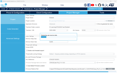

I'm experiencing code generation issues with both Cube software tools on an existing STM32L071CZTX project:
Issue 1 - STM32CubeMX 6.14:
Issue 2 - STM32CubeIDE 1.18:
Steps Already Taken:
Request: Has anyone encountered similar issues with these software versions? Any guidance on resolving these code generation problems would be greatly appreciated.

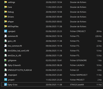

i have some .ftl files laying arount my project root, deleting them (and the MXTmpFiles) does not fix my problem. however, they come back after another generation tentative.
another test i did was to regenerate a new project from my .ioc but cubeMX was denied access to the C:/ drive
so i tried running as administrator. this fixes the issue for the new project generation but not updating my existing one.

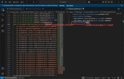

2025-11-12 7:35 AM
I had the same issue for three months already, which caused my cubemx code generation malfunction. Here's the issue:

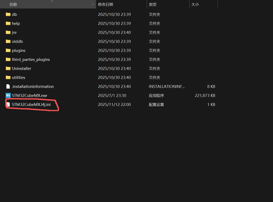

The solution: find the file on the right named below
Type in the last line.
OR: type in same line but replace GBK to UTF-8.

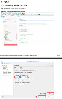

I don't know how exactly this problem occur. According the online information, it seemd that the compiler detect wrong code"UTR-8s", which should be "UTR-8". Here's relative information in the mannual of CubeIDE:
