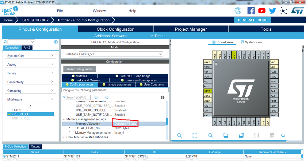

1- I Select a random MCU from the list of CubeMX , (STM32F103C8Tx). then i enable FreeRTOS and in the option I select "Dynamic/Static" for memory allocation.

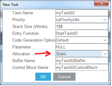

2- then I add a random task but I change the allocation to Static.

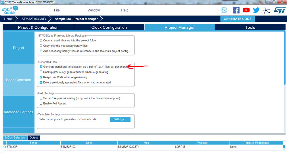

3- I select generate Peripheral init as pair of '.c/.h' files.
4- all other CubeMx options and Freertos options are left as their default. now I generate the project for MDK-ARM V5.

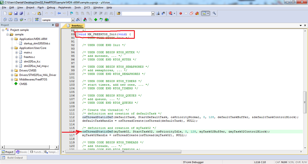

5- I open freertos.c in the project and as you can see the function MX_FREERTOS_Init() is there. (note that if you don't select generate as a pair of '.c/.h' this function is not generated this might have caused the confusion, however, the nature of the problem remains the same)
6- as you can see the function is called from the main function to configure FreeRTOS and Initialize the tasks and mutexes etc.

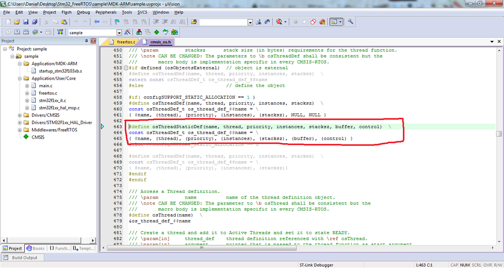

7- the macro
osThreadStaticDef(myTask02, StartTask02, osPriorityIdle, 0, 128, myTask02Buffer, &myTask02ControlBlock);is inside that function. if you open the definition of the macro , you'll see it's just a wrapper to define different
const osThreadDef_t os_thread_def_##namevariables according to the tasks name. this variable holds everything about the task including the task buffer and task control block which is important to us.

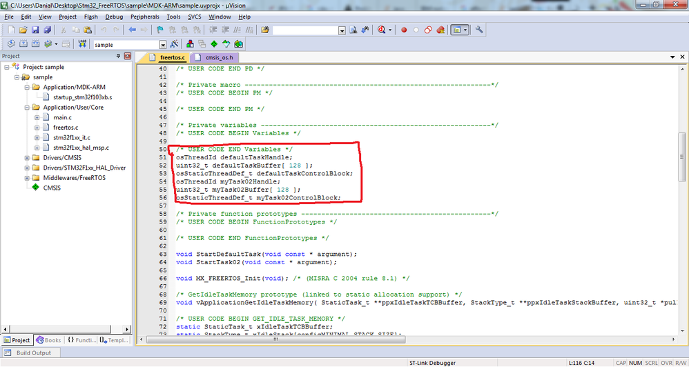

8- the task buffer and task block and other memory units are defined outside this function here :
which are possible to be extern-ed (declared) from other files (which we don't want to do.) however the
osThreadStaticDef(myTask02, StartTask02, osPriorityIdle, 0, 128, myTask02Buffer, &myTask02ControlBlock);which translates into
const osThreadDef_t os_thread_def_myTask02 = \
{ myTask02, (StartTask02), (osPriorityIdle), (0), (128), (myTask02Buffer), (myTask02ControlBlock) }cannot be extern-ed (declared) because of two reasons.
first , it's inside a function
and second because it's a macro defining a variable.

9- Now if I were to delete the task I can do it easily using the task handle. but what If i want to create it again using the same task buffer ?
to over come this we can extern all the needed information including the 3 needed variables to create a static task which is mentioned in number 8.

and second and most important we need to define the task definition again which is
osThreadStaticDef(myTask02, StartTask02, osPriorityIdle, 0, 128, myTask02Buffer, &myTask02ControlBlock);and this means the one that was already defined inside the MX_FREERTOS_Init() is now totally wasted ! and we are losing code space.
10 - to solve this issue the user has to comment line 116 in file freertos.c in this example and move it outside the function.
doing so causes the CubeMX generated code to be modified and then lost again after a code regeneration !
11 - if the "osThreadStaticDef" is moved outside the function the problem of losing code space is solved however referencing it from outside needs manual name referring which is acceptable but that can be solved with another macro as well.
