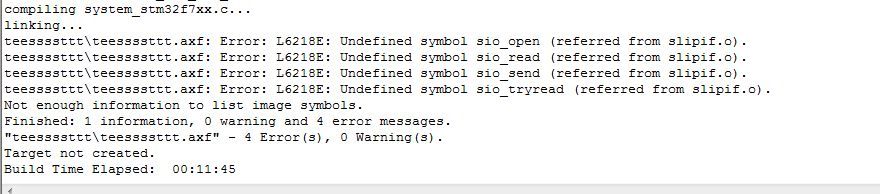

New version of STM32CubeMX 4.19.0 is giving the following error. what is the problem with LWIP version
2.0.0?

, You should review the configuration and the files included of your project.Seems your application does not include object, source or libraries including this function.So,make sure that your project contains all the required library source files.
If your problem is not resolved, I advice you to share your .ioc file.

Thanks for your answer. The same .ioc file is working for
or earlier version of CubeMX. But when I am generating the code using it's not working.2017-04-11 11:45 PM
In the new version, the LWIP library changed to newer version (check the release note). so the file dependencies changed. in this newer version you probably don't need the slipif.c file. It remained from last version. so remove this file from your project and recompile the project. This solution worked for me.
