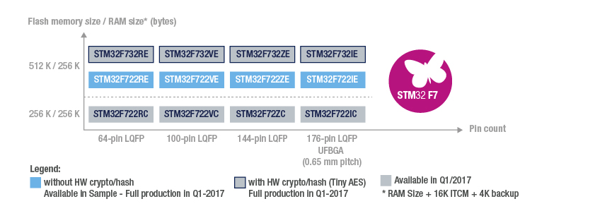

#stm32f7 #stm32cubemx2017-01-04 1:34 AM
Hi
mark.skeete
,For the
we have only LQFP100 package (as it is already presented on CUBEMX): refer to datasheets for more information about PinoutsThe LQFP 64 package is introduced on
, which will be available soon including all ecosystem-Nesrine-

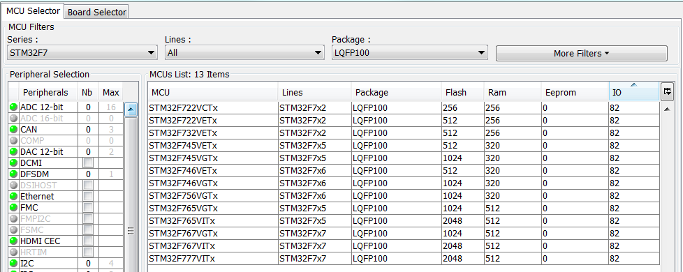

2017-01-16 1:24 AM
Dear user,
Here are the supported STM32F7MCUs in LQFP100 package in CubeMX 4.19 (out this week). This is aligned with the Datasheet. Can you confirm you find the MCU you need?
2017-01-16 8:47 AM
Hi
I'm looking for the 64 pin package.
Specifically, the STM32F723ZE as I think thats the only F7, 64 pin part at the moment2017-01-23 2:09 AM
Hi Mark Skeete,
Please upgrade the CubeMX release to 4.19.
You will have 3 MCUs with 64 pin :
You can see them on ST website as well :
BR
Eric
