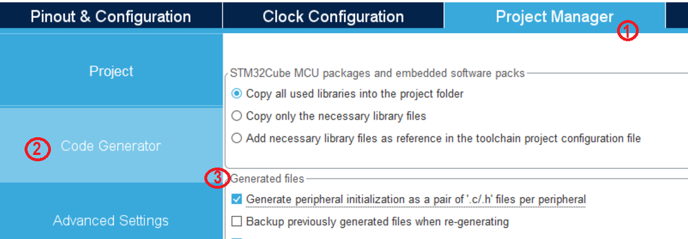

Hello @LMorr.3,
Please check whether the "General peripheral initialization as a pair of .c/.h files per peripheral " parameter is checked or not. It should be checked.
It is placed under Project Manager -> Code Generator -> Generated Files
If this isn't your issue, could you please share your ioc file and explain it more and provide us with a scenario to reproduce it.

In CubeIDE/MX, in the FreeRTOS Tasks and Queues tab, double-click on defaultTask. Set the Code Generation Option to "As weak". Then, the generated code has the StartDefaultTask function defined as weak. I.e. the linker ignores it, if you provide a normal (non-weak) implementation of StartDefaultTask in your files.
hth
KnarfB

Hello @LMorr.3,
