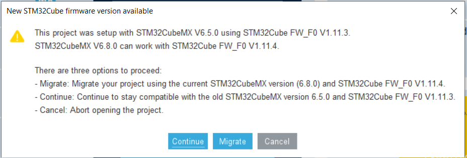

I previously had STM32CubeMX V6.2.1 installed on my machine. I then tried to work on another project that my colleague made and my machine said I would need to “Continue�? or “Migrate�? because I didn’t have STM32CubeMX V6.5.0 installed. So then I updated to the latest Cube MX version (STM32CubeMX V6.8.0) because that’s the only version it would let me update to.
Now feeling like I would have a good chance at victory I opened the same project up and got this:

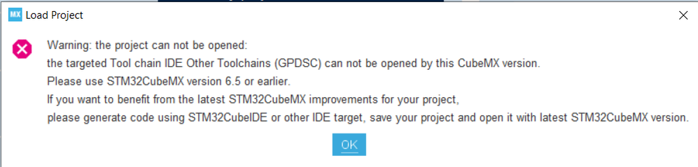

If I click “Continue�? or "Migrate" I get an error message about a GDSC error in the toolchain and it doesn’t load at all.
This means that you've selected generation of a makefile project (not Eclipse/CubeIDE or Keil or IAR). Is this what you use? IIRC this option has been changed in some recent Cube version. In v. 6.8 it is called "makefile".
