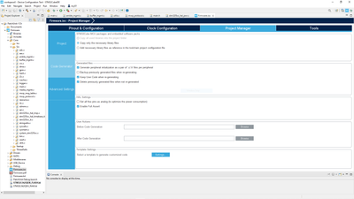

There is a report file also, and that looks right.  The tool just didn't regenerate/update the source.
Screen shot:

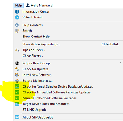

Looks like maybe all the package updates did not get applied.
I manually went in and clicked Check for Target Selector updates and Check for embedded software package updates.  Once I did that and restarted CubeIDE, code generation began to run and completed successfully.
I suspect either a silent failure during the update OR the update caused some component mismatches which the update checks corrected.
Either way, it would have been nice to see an error message.  A sub-one second pop-up doesn't do it for me.
It works to me in 1.15.1 after update MCU Package with Manage Embedded Software Package.
