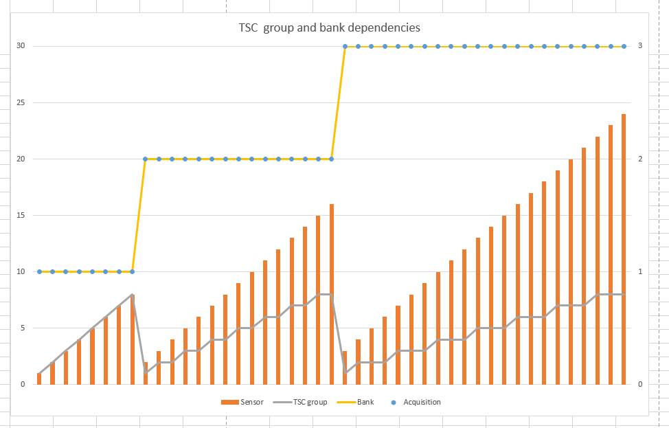

Regarding acquisition and group:
  • In your case (see picture bellow)
    • To get 7 sensors at the same time you need
      • 1 bank
      • 7 groups, mean 7 sampling capacitor
    • To get 7 sensors in 2 times you need
      • 2 banks
      • 4 groups, mean 4 sampling capacitor
    • To get 7 sensors in 3 times you need
      • 3 banks
      • 3 groups, mean 3 sampling capacitor
Regarding wheel or rotary
  • To get 6 channel information, you need to latch 6 channels at the same time
    • To get 6 sensors in 1 time you need
      • 1 bank
      • 6 group, mean 6 sampling capacitor
I will recommend to add an extra group dedicated to shield.
This picture shows TSC, group, bank, acquisition dependencies:
You can get deeper information on AN5105.
