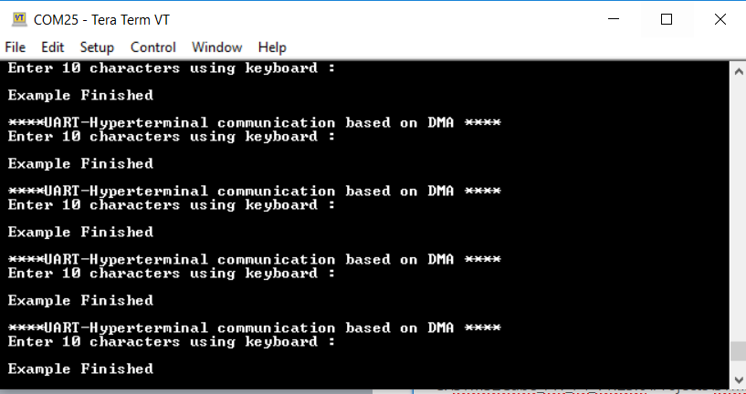

Besides I have tried the example from C:\STM32Cube_FW_F4_V1.23.0\Projects\STM324xG_EVAL\Examples\UART\UART_Hyperterminal_DMA but the example doesn't work properly.
The aRxBuffer doesn't store any of the data from the keyboard.

Hi, I have checked the jumper setting but it still not working as what the examples stated. For instances, the 10 characters from keyboard should appear on the cmd. The end purpose for this is to have STM3240G _EVAL with SPI but there is no examples in the folder STM32Cube_FW_F4_V1.23.0\Projects\STM324xG_EVAL\Examples\SPI , it only have readme.txt which is totally not helpful at all.
