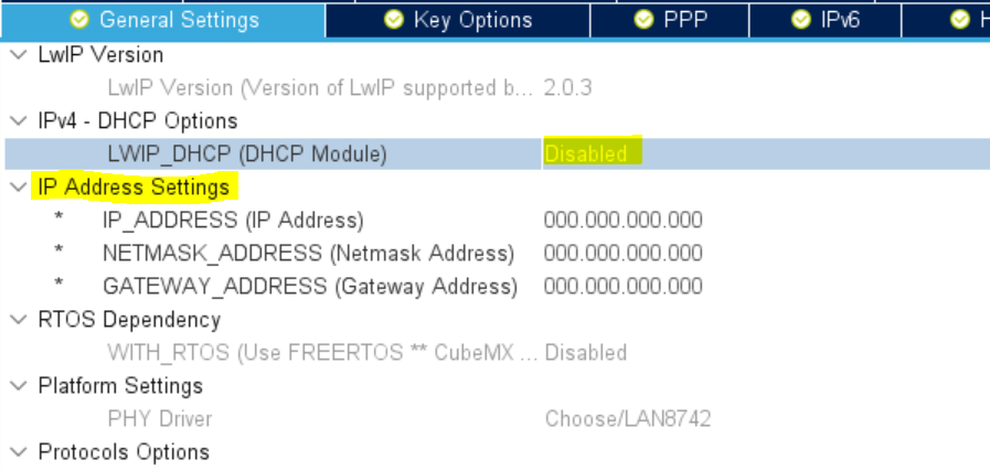

Hello @YiKai
You need to Disable the LWIP_DHCP then under IP Address settings you can update it.
Please use the latest CubeMX release (6.0.1) because there's an issue related to LWIP in the previous version (5.6.1).

Hello @YiKai

Thanks, I use the latest CubeMX release, it's work.
