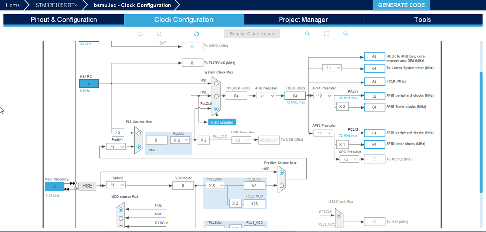

I try to set up a CAN communication between the STM32F105RB and PCAN-Ethernet-Gateway. I have configured all my peripherals with STM32CubeMX (Version 5.3.0) and generated the code for Keil uVision (V5 28.0.0) and Atollic TrueSTUDIO (Version 9.3.0).
I know that the hardware of the CAN bus is perfectly working (because of an other project) so the problem has to be either in my code or in the HAL library. So, my problem is:

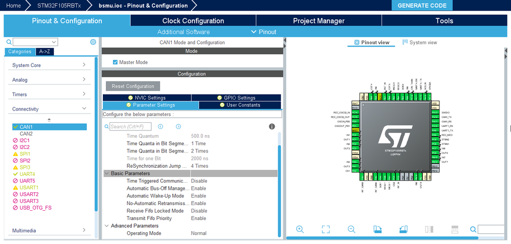

I have made a CAN frame with header and payload and I tried to transmit it with the CAN1 peripheral. I activated all interrupt sources by means of the function HAL_CAN_ActivateNotification(...). I also activated the CAN peripheral using HAL_CAN_Start(&hcan1).
I am trying to transmit the CAN frame when an interrupt occurs because of an empty transmit buffer. I have noticed that this kind of interrupt never occurs. But why?
The flags BOFF, EPVF, EWGF are toggling between 1 and 0 all the time without a recognisable pattern. I try to set a breakpoint in the callback functions HAL_CAN_TxMailbox1CompleteCallback, HAL_CAN_TxMailbox2CompleteCallback and HAL_CAN_TxMailbox3CompleteCallback.
Is there anything wrong with the code that was generated by STM32CubeMX or is it my code? Is it necessary to configure a filter for CAN?
