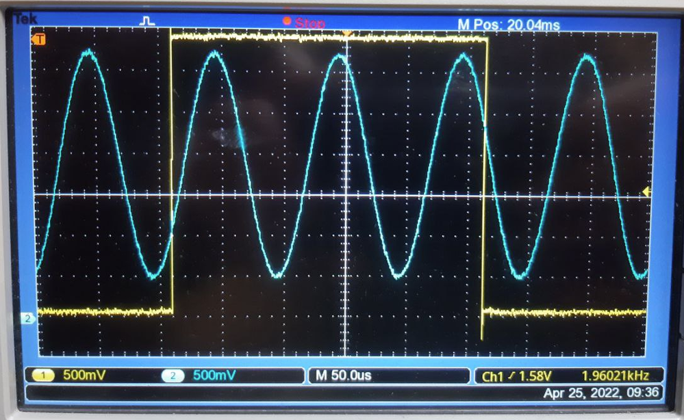

Now to my problem: The ADC is triggered by a timer update event. Then the data is transferred via DMA to a buffer. The problem is, that the values in the DMA buffer are random (?) values. I verified with an osilloscope that the timings of the measurements are correct:
The yellow line is toggled after the buffer is filled completely, the blue line is the signal to be measured. The sampling frequency (and the frequency of the timer) is 500kHZ, so well within the ADC spec (event the slow ones have a sample rate of 1MHz). The buffer has a size of 256, so the frequency of the yellow line fits this as well.

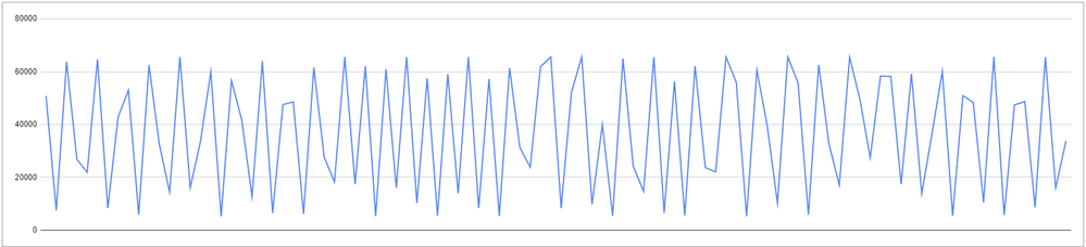

This is what the first 100 values in the ADC buffer actually look like:
Looks like a sine wave with a really low sample rate, doesn't it? But if the
HAL_ADC_ConvCpltCallback-interrupt is called at the right time, then this should be the first sine wave. So it makes no sense.

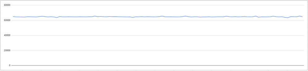

The DAC is working though, this is what a constant 3.2V looks like:

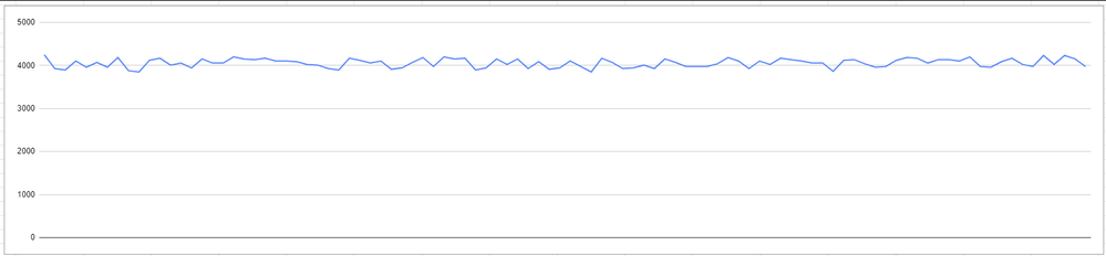

And this happens if I leave the input floating:

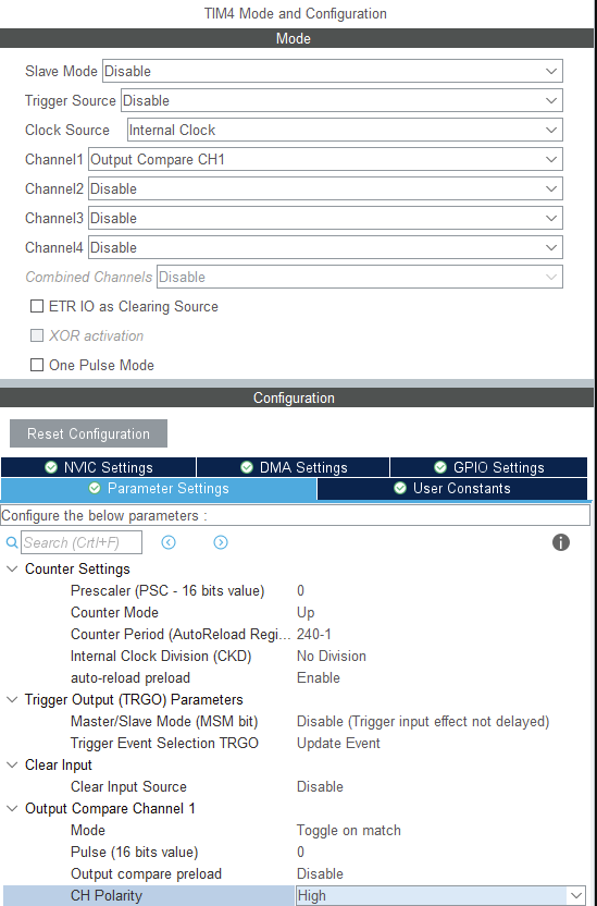

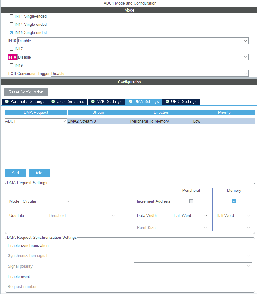

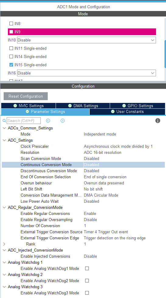

- the timer, dma and adc setup:

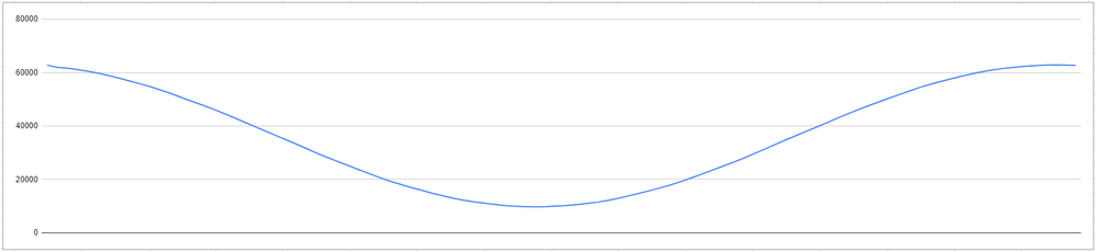

UPDATE [solved]:
There was no bug at all. Thanks to everyone and their great ideas I learned today that a breakpoint does not stop DMA and interrupts. Therefore the data that the debugger got was a random mess from multiple cycles. Here is how it looks now:
2022-04-25 9:14 AM
Real data? Yes. Data from the same capture? No, not if the DMA is continuously refreshing data. Timers don't stop by default when the system is paused. Debugger accesses to read data on the chip are not particularly fast, especially in the context of your ~250us buffer update time. Again, very easy to confirm this by slowing down the frequency and observing.
