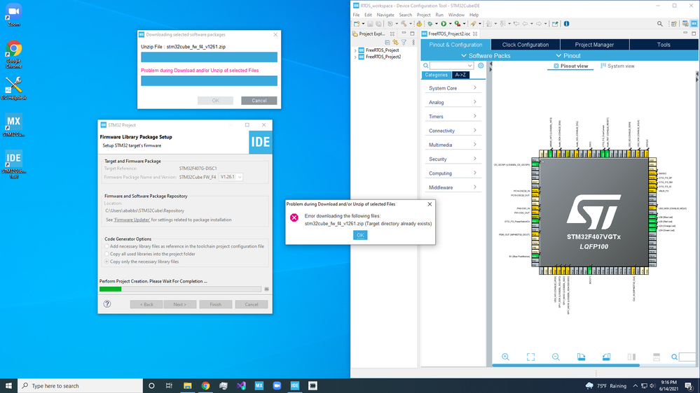

error: cube firmware cannot be installed into repository.
a file or directory with name same already exist.
The cause of this error = old time add firmware and not remove with stm32cubeIDE or stm32cubeMX.(manually removed or uninstalled stm32cubeIDE / Stm32CubeMX before remove firmware with stm32cubeIDE or stm32cubeMX).

if old time in "Embedded software packages manager" use of "From Local..." for install this zip file now need change zip file address. (move zip file or change folder name)
2020-12-17 9:36 PM
After two days of increasing anger (:pouting_face:) due to continuously failing install a new subversion pack (STM32Cube_FW_F1_V1.8.3) this is what I found: the previous folder (STM32Cube_FW_F1_V1.8.0 ) was rewritten but, unfortunately, without changing the folder's name. This is the reason everything worked OK in the installation's beginning (downloading pack, un-zipping and installing) but failed in the end as the software was looking for the un-existing folder STM32Cube_FW_F1_V1.8.3 . To overcome this issue (until STM solve the problem :sleeping_face: ) I had open "C:\Users\my_user_name\STM32Cube\Repository" , and manually modified the folder's name to STM32Cube_FW_F1_V1.8.3 to match the last installed pack name. And ... magic happened!

ST has updated it via zip files that only show up when you fail a new project.
OKAY. So for those who are having this specific issue:
The solution is:
1: Open the widget STMCubeIDE
2: Go to "Window" in top menu and click "preference".
3: Click "STM32Cube"
4: Click "Firmware Updater"
5: Look at where your repository is stored: it looks like this " C:/Users/"username"/STM32Cube/Repository/ "

I had this frustrating issue on Windows 10 Pro. I solved it by creating a new folder for the repository and changed the repository settings to that new folder.
Installation should be successful and you should be able to generate code.
