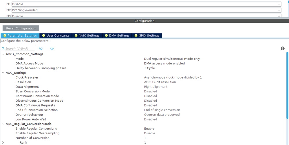

So I wanted to use a single DMA with the Dual regular simultaneous ADC mode on a NUCLEO-L476RG. However I noticed that just the master ADC value was present in the buffer of the DMA, even though the Data width of the DMA is set to Word.

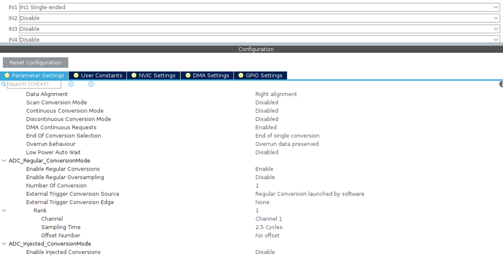

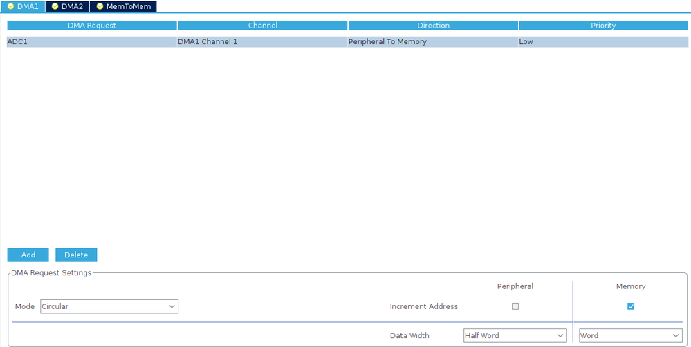

FYI here is the parameters I set in STMCubeMX v5.6.0-RC6:

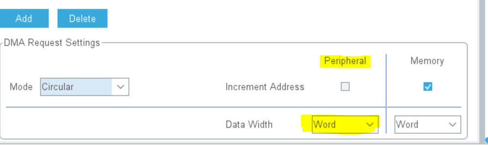

Hello @GDuc.1 ,
You just need to change the Data width to Word,

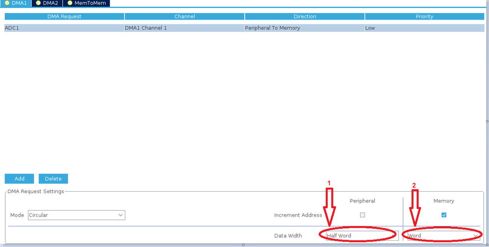

2020-04-14 8:46 AM
Hi @GDuc.1
PeriphDataAlignment generated in the code is none other than data width for peripferal.
MemDataAlignment data width for memory , configured from DMA table and not ADC
So, the answer is Yes, you can do the configuration from DMA table.
