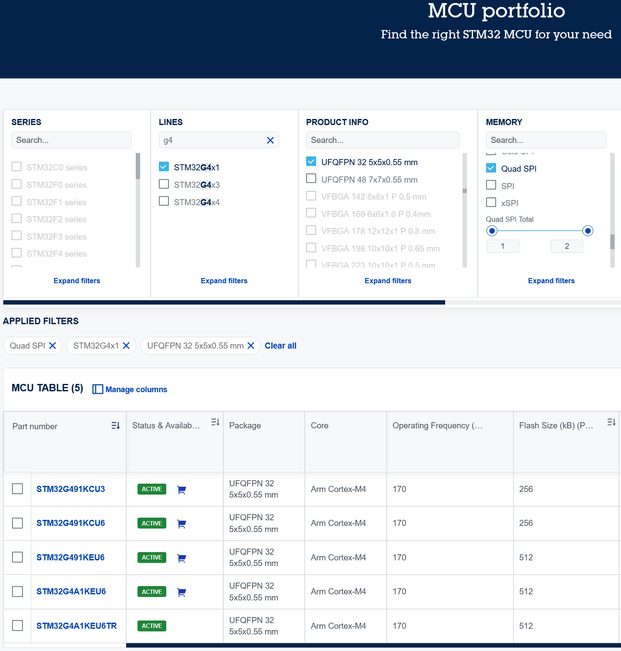

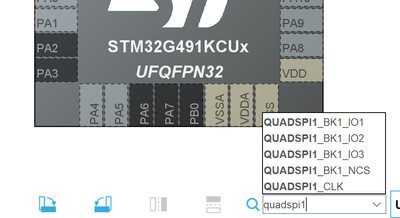

Does the STM32G491KC have Quad SPI capability? The documentation and product selector tools (on website and within Cube IDE) say that it does have QSPI, but when I try to configure it within the Cube IDE the options is grayed out with the message "Dual Bank mode must be enabled"

The UFQFPN32 package is missing a pin for IO0, so QUADSPI cannot be used.
It's a minor bug that it shows up in CubeMX at all, but the program is correct not to let you enable it.

Thanks, that makes sense. I originally selected the part by using the STM32 product selector and choosing Quad SPI as a requirement.
The error message in CubeMX confused me because it said I needed to enable Dual Bank mode, when usually it will tell you when a pin isn't available.
The App Note AN4760 "Quad-SPI interface on STM32 microcontrollers and microprocessors" also lists the STM32G491KC, with the table there giving a bunch of examples of other packages that are missing QSPI but nothing about the 32-pin QFN not having it.
