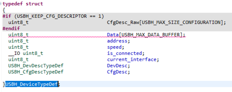

Another error is :
USBH_DeviceTypeDef has no member name 'CfgDesc_Raw'
in this line :
And when I go to the definition of USBH_DeviceTypeDef, I have this :
So if we want CfgDesc_Raw, it's because USBH_KEEP_CFG_DESCRIPTOR == 1 (and I checked, it's true), but if we don't have it in the structure, it's because the same macro != 1...
What happened ? Why can't I use this library properly ? Do you have any solution I can try, please ?
