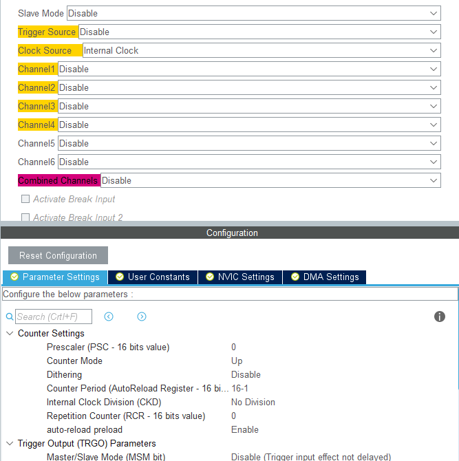

Timer1: it has a 1us overflow time and is not handled by any interruption, I just use it to count micro seconds for my delay_us function.

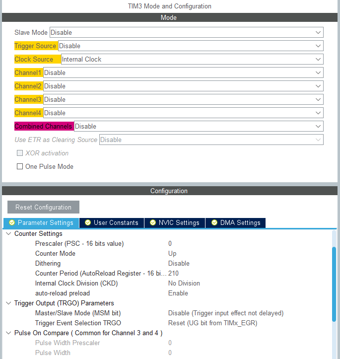

Timer3: its configured with a interruption frequency of about 76.2kHz and it is handled by an interruption. This timer is used to modulate an output so it should only negate a variable and make an and operation between that variable and the output.

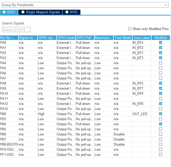

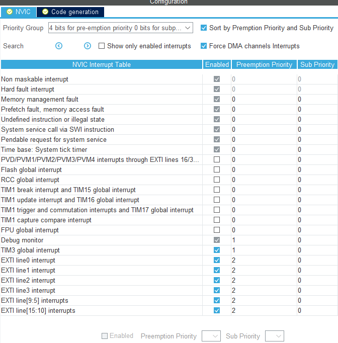

}Here I leave the code and configuration:

2021-11-11 7:11 AM
It's probably stuck in TIM3 interrupts given that your period is only 210 ticks. Run the code, hit pause, then see where the MCU is at.
