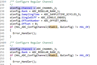

Hi @giancarlofi,
I checked your ioc file and the line for ADC_CHANNEL_2 is generated:
Make sure to use the latest release of STM32CubeMX and STM32CubeG4 firmware package.
2024-08-23 2:41 AM
Hi Imen, thank you for your response but the adc is hadc5 not hadc2.
