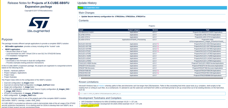

It is mentioned in the release note projects of X-CUBE-SBSFU Expansion package that the development toolchain and compiler used for this package is STM32CubeIDE v1.9.0. For that please try to update the STM32CubeIDE toolchain.
Also, possible build issues may be caused by too long path names. I suggest you to unzip the package in a short path like e.g. C:\work.

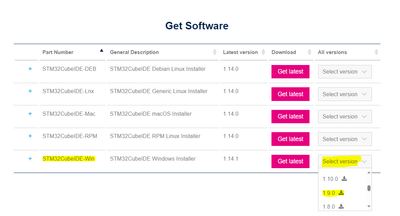

I couldn't find STM32CubeIDE 1.9.0 The latest version on the link you provided is 1.4.1.
2024-02-22 5:52 AM
Hello @tarbal ,
You can find the STM32CubeIDE 1.9.0 on this link and by choosing the version "1.9.0" in "Select version" as shown in the below figure:

2024-02-22 5:54 AM
I mean STM32CubeIDE 1.14.1.

I installed the version 1.9.0 as recommended in the release notes. It works.
