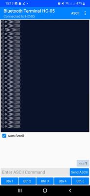

I'm having trouble with ADC2 and ADC3 on my NUCLEO-L010RB board. I've utilized all 16 ADCs on the microcontroller, and the code is functioning correctly except for these two ADCs. I am using LPUART.
In this image, I obtained a reading of 40 from all the sensors connected to ADCs, corresponding to the ASCII character "(". However, ADC2 and ADC3 consistently display the same value, even when I modify the input to any value other than 40. These two ADCs persist with this issue.

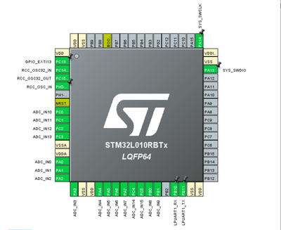

This is the configuration.

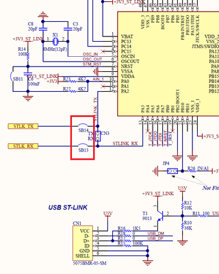

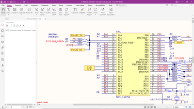

You need to disconnect STLINK-VCP from your MCU by desoldering SB14 and SB13 and solder solder bridges SB62 and SB63:

How to Change the solder bridges SB62 and SB63 to allow the ADC in2 and in3 to work as ADCs?
2024-05-07 12:57 AM - edited 2024-05-07 1:05 AM

Thanks, I think it's my problem. But before doing that, I have a question: Can I run new code on the Nucleo board after desoldering SB14 and SB13?
2024-05-07 2:10 AM - edited 2024-05-07 2:10 AM
Didn't understand your question!
SB14 and SB13 are used to connect/disconnect STLINK-VCP from your UART.
