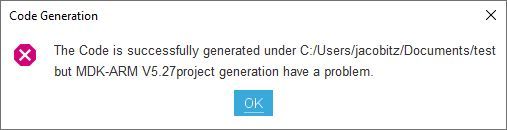

I use CubeMX to configure STM32 controllers (mostly STM32F746ZG for testing on a Nucleo-144 board, but also tried with other boards and single MCUs).
Since I moved to Windows 10 64Bit, the generation of SW4STM32 projects does not work properly anymore (both with newly created and old IOC files). The following problems appear:
- The MCU (to be configured in SW4STM32 under Project Properties -> C/C++ Build -> Settings -> MCU Settings) is not configured. This does not allow the selection of FP hardware.
- The linker script is not created / linked to the project (probably a consequence of the first point).
I use the following program versions (latest updates):
- CubeMX v5.5
- CubeF7 Package v1.15.0
- SW4STM32 v2.9
I have also tried a complete new installation and the usage of older versions. The problem remains the same. Also, the generation for MDK-ARMv5 shows a similar effect with the additional error message:
Does anyone have an idea what the problem might be / how to fix it?
Thanks for your help
Sven
