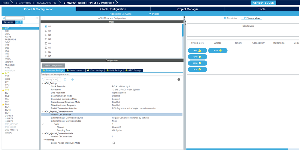

  1. Open CubeMX the select board :STM32F401RETx
  2. Select ADC: IN0 ==> * Go to Parameter Setting: Enable Continuous Conversion Mode, *Go to Rank: Sampling Time: 480 Cycles

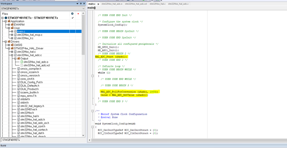

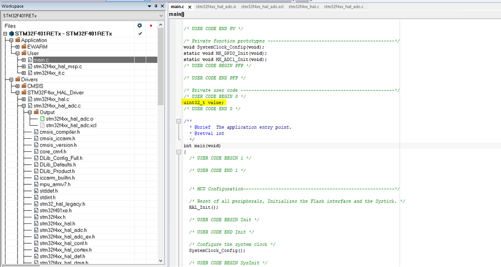

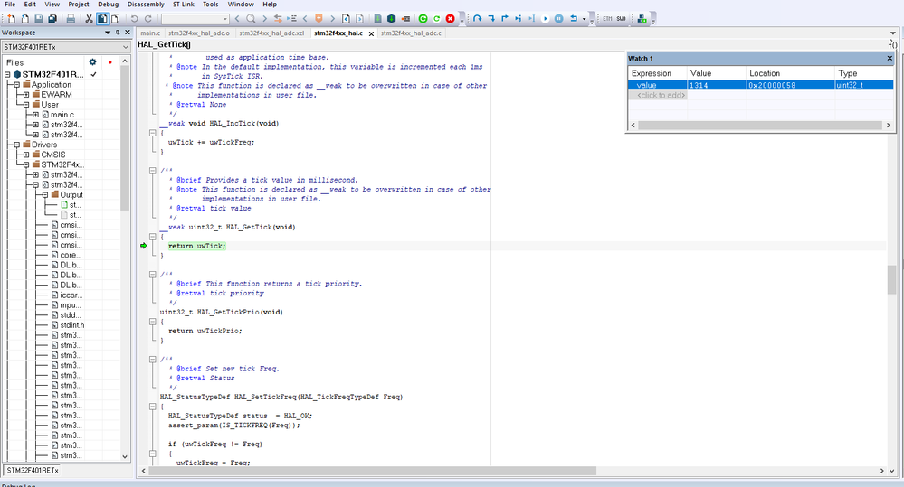

  5. In the main.c file : create a variable to store values from ADC0690X00000983MIQAY.png
