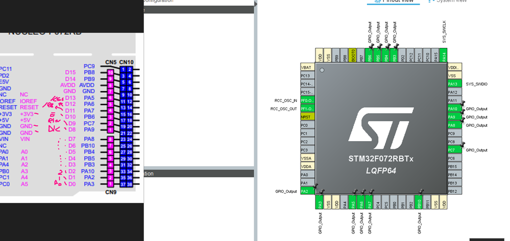

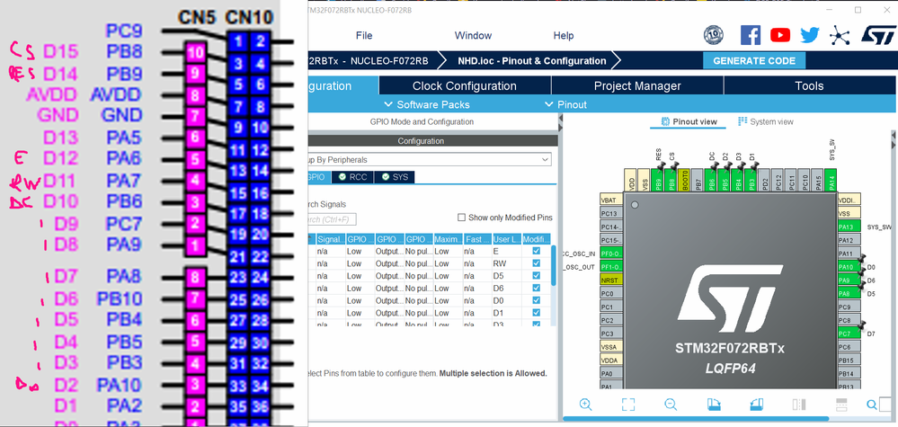

and here is the CUBEMX pin I/O's (D11 RES,D12 CS)

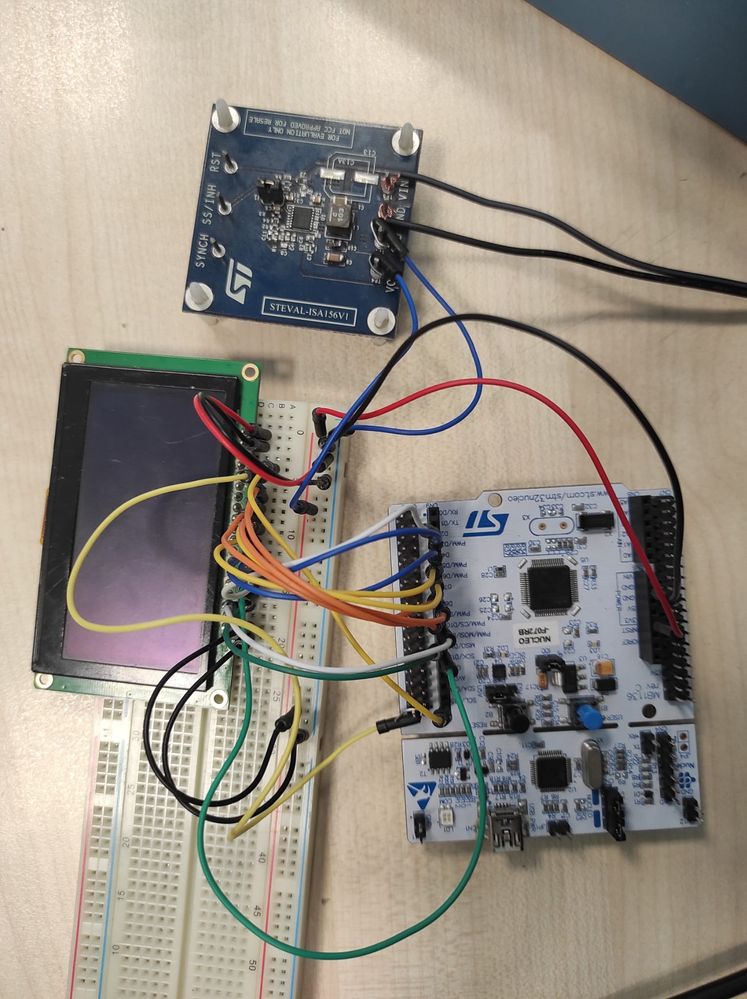

0693W00000aIU3KQAW.pngi tried to supply it with external voltage 3.3v so i don't think there is any ampere or voltage problem.
The display doesn't show anything when i power it so i don't know what to do

Common grounds? When you used an external 3.3V supply, what kind of current did it draw.
Show wiring to OLED header.
yes i plugged them in Breadboard so i think it's common ground The external supply i'm using is voltage regulator STEVAL-ISA156V1. The wiring of the setup is like this 0693W00000aIZstQAG.jpg
sorry i don't have a logic analyser im checking the pins with multimeter
And i tried to measure the pin signals but it seems like D0 and D1 pin doesn't work properly. Or it does but im new to stm so i don't know how to use them as output. so i arrange the pins like this0693W00000aIa1KQAS.pngRes pin is at PC8
