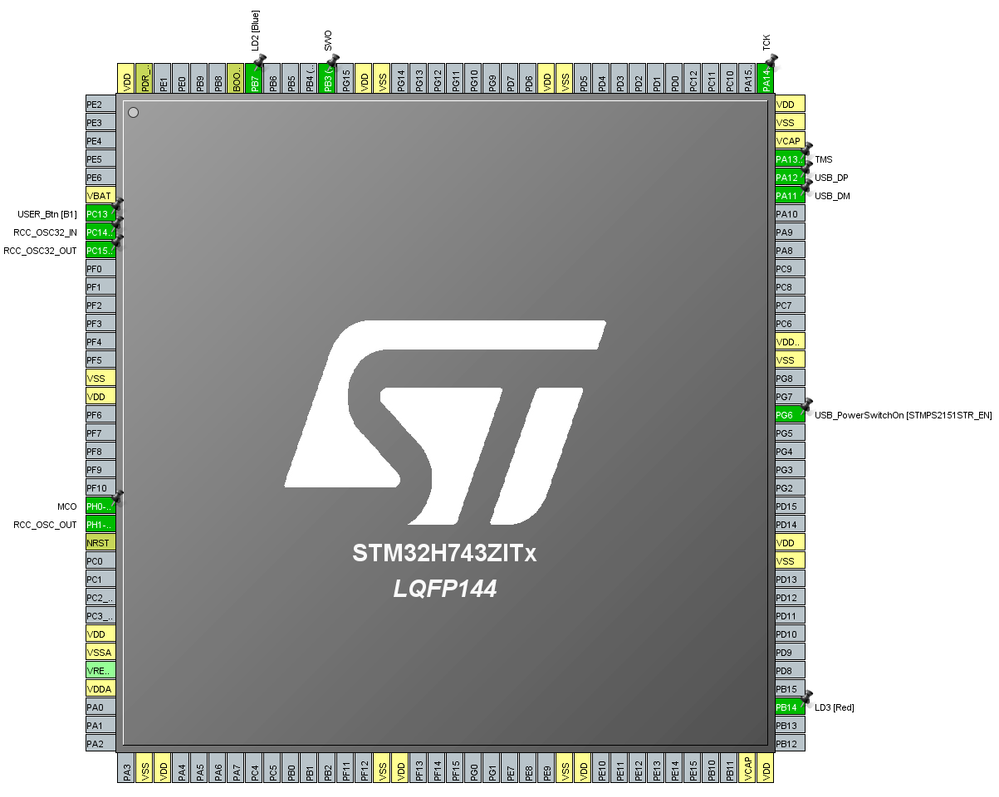

1- Started Cube32MX, selected NUCLEO and reset all no essential pins. See photo.

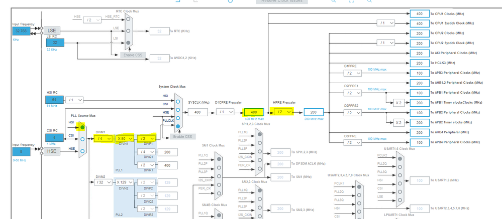

2- Clock configuration is set to 96MHz. Trying to set clock to 400MHz creates a never ending search

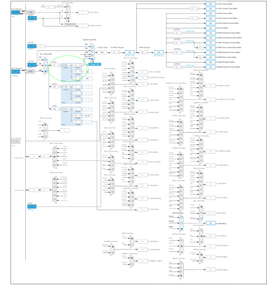

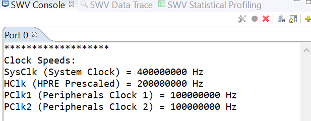

2019-02-03 9:11 PM
OK... another tweak and now it seems to work. Changed the PLL Source MUX around so System Clock driven by HSI....
... and now we have 400MHz clock running and print(f) working also at all above speeds.... not easy

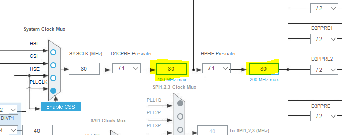

May have resolved my own problem [Edit: Eventually ! See next few posts ] . I tweaked the highlighted region to create desired results, with some adjustments to the /Dividers in the top-right Clocks to limit to 100MHz where needed. Initial results on Build and Debug in TrueSTUDIO show it is operating OK. Resolve Clock Issues could not reach this result after > 1 hour.

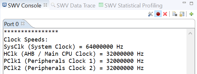

Still completely up in the air on this one. Using this code in main.c...
uint32_t SysClk;
uint32_t HClk;
uint32_t PClk1;
uint32_t PClk2;
SysClk = HAL_RCC_GetSysClockFreq();
HClk = HAL_RCC_GetHCLKFreq();
PClk1 = HAL_RCC_GetPCLK1Freq();
PClk2 = HAL_RCC_GetPCLK2Freq();
printf("*******************\n");
while (1)
/* USER CODE END WHILE */
/* USER CODE BEGIN 3 */
printf("Clock Speeds:\n");
printf("SysClk (System Clock) = %lu Hz\n", SysClk);
printf("HClk (AHB / Main CPU Clock) = %lu Hz\n", HClk);
printf("PClk1 (Peripherals Clock 1) = %lu Hz\n", PClk1);
printf("PClk2 (Peripherals Clock 2) = %lu Hz\n", PClk2);I got the following result from the supposed 400MHz config above (only 64MHz):
... BUT when I changed the Clock Config back to a 80Mhz ...
... the resulting clock speeds were reporting correctly; and higher!
So either CubeMX just isn't writing sensible code (likely) or the HAL_commands used to read them are wrong. Either way, it's another hair pulling day with the STM32H7
2019-02-03 9:11 PM
