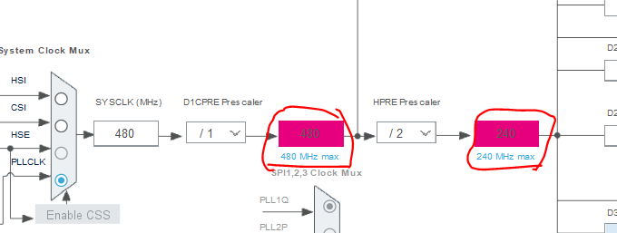

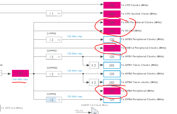

Updated CubeMX as well as H7 libraries, and now see problems with clock configurator, as well as some LL function calls in system clock init has no definition !
STM32H743XI should have 480MHz clock...

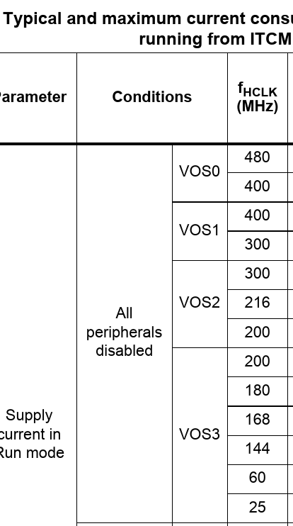

but : which core voltage you choose? depending on this setting, max. clock is lower, see ds.
here for H743 (i use.)

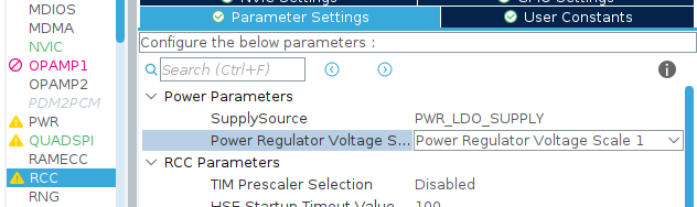

2022-12-09 11:11 AM
no, core voltage settin ! this is vdd supply.
this :

2022-12-09 11:39 AM
you got the "update surprise" !
maybem they put it from RCC to elsewere , look in PWR, cortex_M7, ..
i use :
STM32CubeH7 Firmware Package V1.10.0 / 11-February-2022
CubeMX 6.6.1.
