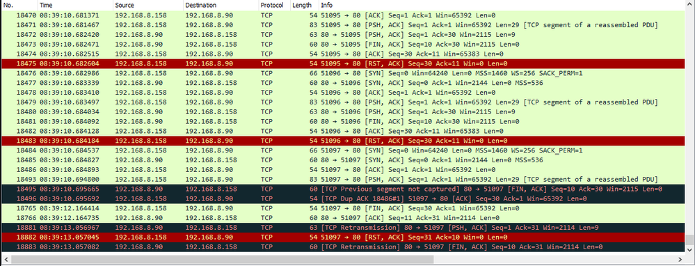

If I try to recreate the same conditions using STM32CubeMX I begin to experience periodic lag. The continuous stream of HTTP GET commands is actually sent as a burst after which the devboard seemingly crashes and I am kept waiting for a timeout. After a small halt, this communication is reestablished once again and I can send another burst of messages. If I inspect the Ethernet traffic, I can see that each crash is followed by a bunch of TCP Retransmission, TCP Previous segment not captured or TCP Dup ACK errors:
As I've mentioned before, the LwIP_HTTP_Server_Netconn_RTOS example does not behave in this kind of segmented fashion - I can continuously send and receive TCP packets to/from the board.

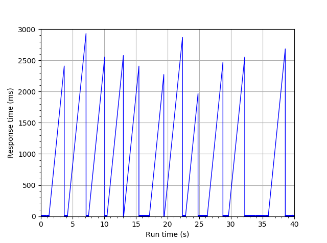

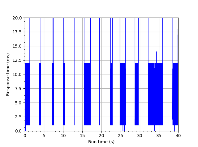

To illustrate my point, this is how the CubeMX-generated code responds to a “GET /STM32F7xx_files/logo.jpg�? query:
And a zoomed in version:
x axis represents the absolute time when the query was issued (since the beginning of the measurement). y axis represents the time it takes for the devboard to respond to the said query. When all is OK, each query is transmitted and the answer is received in a manner of few ms (therefore we get these thick, densely-packed regions of transmission/reception). The sharp spikes with the huge gaps in x-axis in-between them represent the time when the said TCP issues take place.

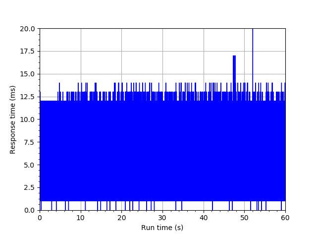

Contrarily, these are the results that I get from the LwIP_HTTP_Server_Netconn_RTOS example:
Essentially, I always get response on average in about 2.66 ms (with a standard deviation of 3.5 ms).
